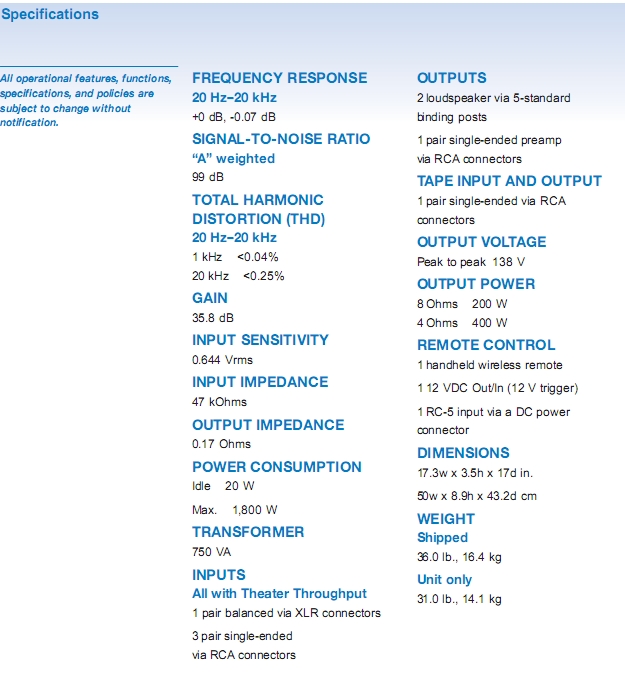

Anil buddy It might just be a little less !! Am sure you might've missed the spec of this krell, so only you have recommended 2Kva ! once you see Am sure you'll agree with me!
Well if its for krell 400 Xi then you might have to go for a minimum of 2.5Kva converter !! the krell manual says max of 1800watts power consumption,so anything less then 2.5Kva will sure have adverse effect on the system !!

Yes the Krell will draw lots of current for sure and 3KVA should be the best option. If its 1800W then 1800 into a 4ohm or 8 ohm load? If its 1800W at 8 ohms then will consume much more and heat more into a 4 Ohm load. Am not sure of the krell specs so its best to confirm this. Of course this is at max output and one is never going to venture there but its better to err towards safety in these issues.

Dinyaar the spec doesn't mention whether its @ 4Ohm or 8 !! it just says max 1800watts !!
I've attached the spec of that here for reference ! please check !
