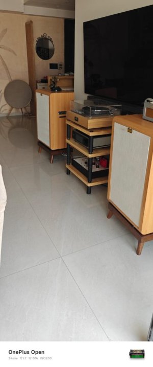

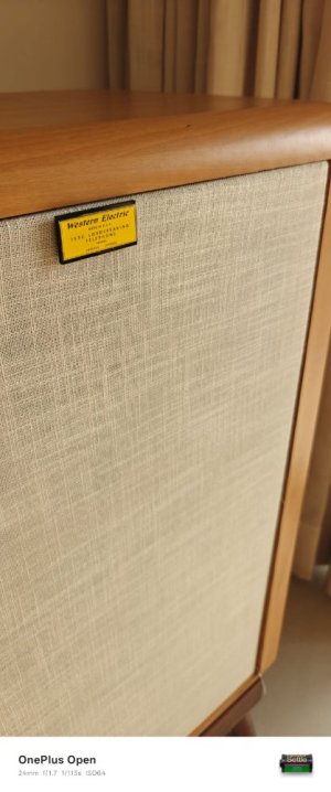

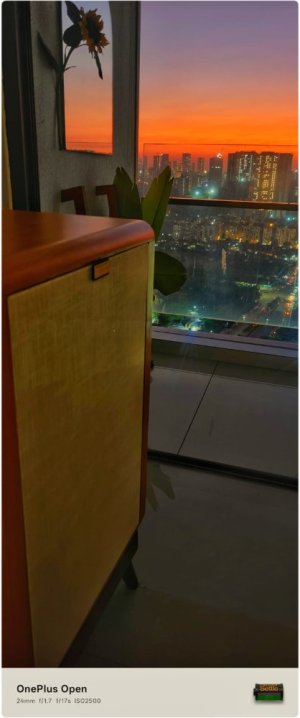

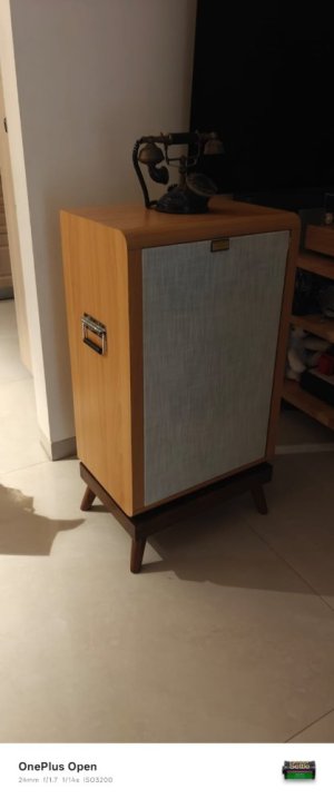

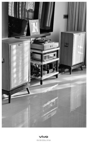

Description:
Cabinet: Western Electric 753C
LF: Altec 414A. 12 inch Alnico low frequency/midrange driver. A cult status driver.
HF: 804A, a well know compression driver with alnico magnet, it identical to the iconic 802D. Differs only in terms of magnet strength and intended for home application.
Horn: Altec 32b. A near replica of the WE 32 horn.
Joe Roberts (famous DIY guy) and Jospeh Esmillia of Je Labs conceptualized this speaker. The cross over has many permutation and combinations. Some run the 414A full range, mine is crossed at 1500 hz. Best part of the speaker is that its small, looks beautiful, tried and tested by several Altec fanatics over decades and most importantly, the 32b horn, even at a small distance does not get overbearing. A near perfect Altec for small to medium space, which can scale.
When I hooked them up with my 2 stage 300b amp (We 417a + Elrogs 300b), they put a smile on my face. Sometimes, and rarely sometimes, we audiophiles hit it right away. This one such rare occasions. Warm, inviting, lively and a sense of 'its fucking good'. I have heard good things about Altec 414A and they did not disappoint.

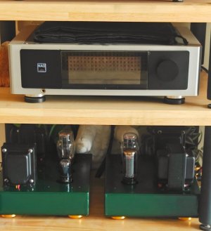

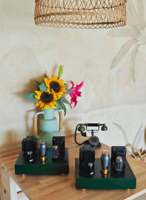

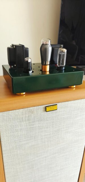

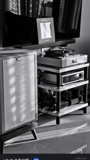

Je Labs Simple 45/2a3
After hearing Altecs with my friends Je Labs 45/2a3 monoblocks in Bombay, I decided that at 100db sensitivity, I can convert to Je Labs 45/2a3. It’s cheaper to make, live with and tube roll. And, with Altecs at 100db, unlike with Omega's, 300b did not give any significant power and control advantage over 2a3 or 45. I have gone back and forth with these 3 DHT a lot in the past, I wish I had money to keep all the three. But it is what is. Selling 300b amp/tubes was a huge boost to my pocket. Took some sting out.
Next few months was a journey to replicate Je Labs 2a3/45. I gave the entire job to Asnain of Kolarkar Audio. He has done a stellar job for my friend already. We just had to replicate it. No reinventing the wheel. We went all out, best that he can make in terms of the OPTs, chokes, best that I can afford. My brief was clear, cant compromise on sound or looks. After a long-long wait, they were finally delivered.
They look beautiful and sound surreal. There is an ease to the sound which I associate with well-made high end tube amps.
It is:
a) easily one of the best amps I have heard or owned. I have heard/owned a lot of high end tube gears and it’s not a reckless honeymoon phase remark; &
b) easily the best amp for midrange clarity, tone and texture I have heard or owned, especially with 45 Tube engaged.
c) Looks beautiful. On look alone, it is bettered only by the Leben that I owned briefly.
They mate perfectly with Altecs. Not a surprise since both the speaker and the amp are brain child of a single individual, who uses the very same setup as his current main setup. A lot of audiophiles use this very same amp, albeit in their own ways. There are thousands iteration of this same amp all over the world, with varying components, I havent heard anyone who aint thrilled. Testment to the simple circuit and old ways of doing things.
Conclusion
Last few years have been a fast and tumultuous journey in this hobby. Responsibilities and obligations will eventually slow it down. May be it has. Happy that I reached this far. Wont have been possible without the support and guidance of audiophiles in this forum and elsewhere. I do not want to make any statements whether I am fully satisfied at this point of time, but yes, I have found happiness in the pursuit, through and through.

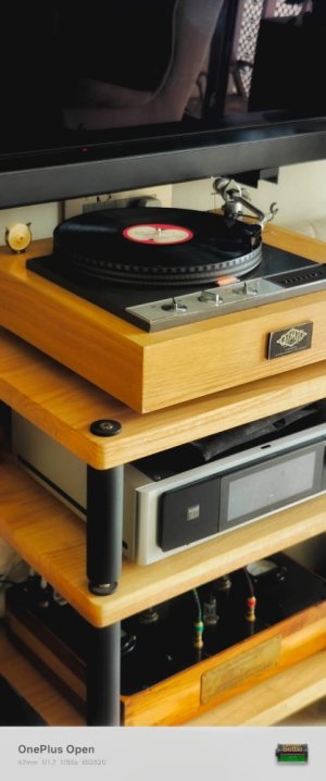

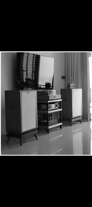

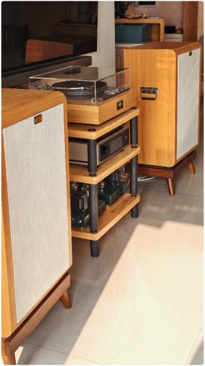

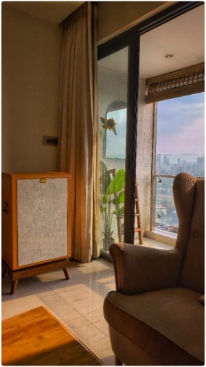

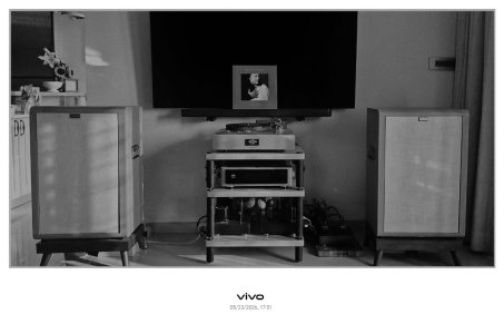

Attaching few pics for the joy of things.
The Altecs/Je Labs is ably supplemented by front end consisting of CD Player (Cary 303T Pro), Vinyl (Garrard 401 + SME 3009 II) & Streaming (NAD M66).
