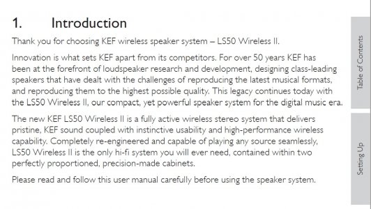

KEF LS-50 II has a plethora of input options and covers all streaming formats on the earth. However, it is a stereo system as per the manual. It was on my radar before I settled to build a pair of Am Camp Amps.
