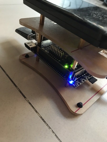

First combo test : Only Sparky and the Piano 2.1
Got the packaging out and began assembly, took 10 minutes to get the Sparky and the Piano connected. Inserted the Card , connected it to my TV via HDMI , attached a USB dongle for a Android keypad/trackpad. and powered it on via the given 5 volt power supply. A USb portable drive with music was attached to the USB 3 port. No separate power is required for the Piano 2.1, it draws power from the Sparky
The Screen came to life and i had a sigh of relief. Ubunto was up and running.

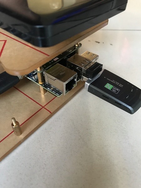

The Niggles mostly with the WIFI Stick
Wifi was not running though, neither was the device showing.
Ran the hardware tab and it was building a driver list, it then showed a wireless card and auto enabled it. The menu bar on top of screen then showed the wireless ICON. connected to my wifi network and it said i had updates did the update and it rebooted. Now wireless was gone again.. Connected to a Lan via network cable and mysteriously the wireless lan showed up again.

Pictures of the setup :
This is with a HD kept on top of the DIY console

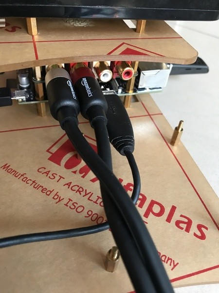

The RC out connected via amazo basics 2RCA
The supplied WIFI dongle connected

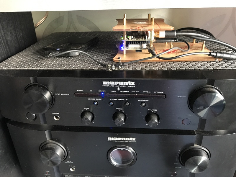

On top of the Marantz PM6006
