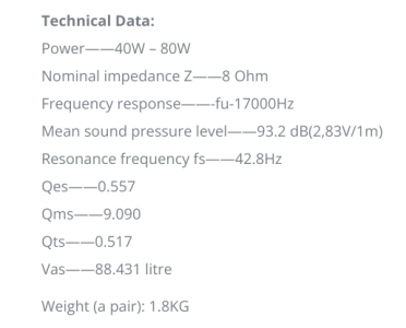

The driver has quite high Qts at 1.32, so it’s made for OB only.
Do you know for sure that this is true? Because the Lii Audio site shows specs very different from this and I doubt that they could have so much of a difference. Perhaps they redesigned this driver???
F6 was made and marketed as an inexpensive car FR. Even specs printed on the basket were wrong. Probably they did not take the driver seriously but I was given a free pair to try and it had an uncanny resemblance to the Coral Flats.
My hunch told me it’s made for OB. I measured the TSP using Dayton Audio DATS V2 and here they are:
F6 TSP: 93dB, Re6.7, Fs 84, Qts 1.32, Qes 1.7, Qms 5.92, Le 0.126, Mms 6.58, Vas 0.633.
Subsequently many measured it around the globe and had similar readings.
I too read in other forums the above measurements are true
