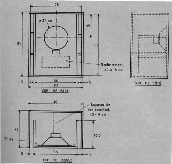

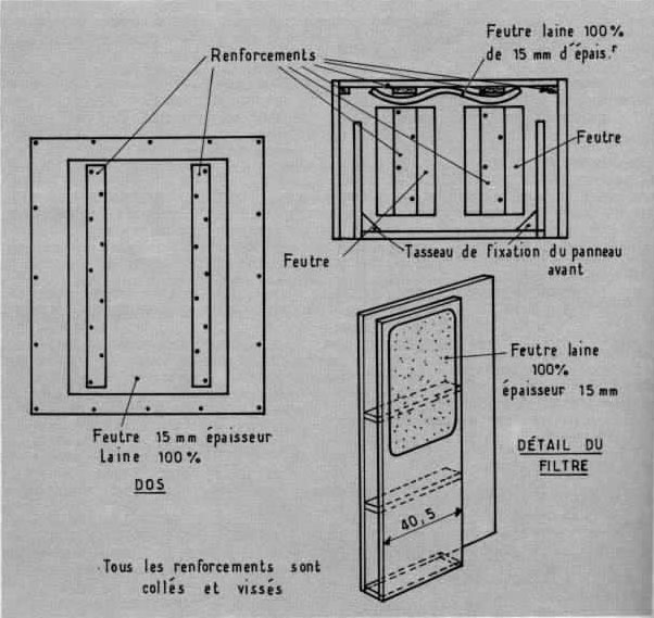

After a lot of reading on the net and reading about different designs for enclosures. I am now leaning towards building Jean Hiraga's Onken design.
