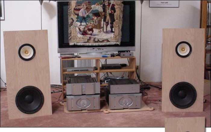

I dismantled the setup after testing for a few days but put it back this morning to snap couple of pics for your reference.
whoa! gobble -
that feastrex driver - the paper for that cone is made by japan's national living treasure! -
that plan does not belong on this thread - not when each of those drivers will burn a $4000 hole in the (idiot) buyer's pocket!

whoa! gobble -
regds suri
Thought it would inspire our open baffle fans here, but you only baffled them by quoting the price :)
