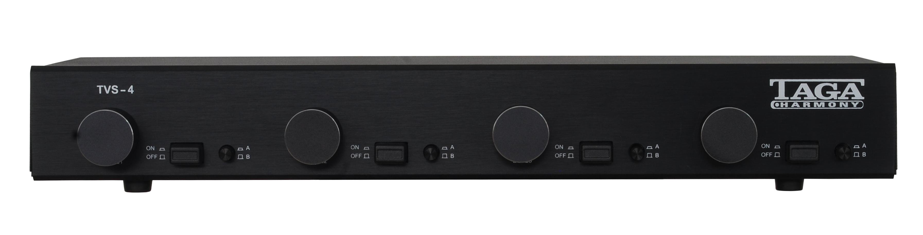

Instead of connecting all speakers directly to AV Receiver, I suggest using a speaker selector like Taga Harmony TS4 - Costs around 6000.
If you are going for 1509, you can connect Front Left/Right to towers and Surround Left/Right to Taga Speaker switcher.
I recommend 1609, you can use 5.1 in the living room and take zone 2 out to speaker selector. That way you can watch a movie in living room in 5.1 mode and at the same time listen to music from another source in other rooms.
Thanks. Looks like the exact thing I need.
Can multiple zones be activated simultaneously? In that case, the effect will be same as a parallel connection, but the selector will manage the impedence drop? Is this correct?
In that kind of setup, the speakers in the said zone needs to be getting input from 2 sources. One being the selector (from AVR). And at a time any 1 source will be on? Right? The selector from AVR is off for the said zone and another source is on. Correct?
Yes, you can enable multiple zones simultaneously, you need to press the protecting circuit switch. From the product page:
This selector is equipped with the impedance protection circuit. Once activated regardless of the number and nominal impedance of connected speakers it protects the audio source (amplifier) from being damaged due to impedance drop.
The Taga speaker selector supports only one source. You can connect Zone 2 outputs from AVR as input to speaker selector.
In the AVR you need to select in the setup that you are going to use 5.1 + Zone 2. Refer the below page to find out the terminals you need to use for 5.1 + Zone 2
Now in the AVR you have the option to choose what is the source you want to use for mains and what is the source you want to use for Zone 2.
You can select Bluray or CAB/SAT in mains as input , press Zone 2 button on Remote and select the source you want for Zone 2

I found this model as well, it supports two sources, for every room you can choose first source or second source, this model also support individual room volume control. This model also supports 100RMS per channel, previous model supports only 70W RMS per channel.
I don't have the pricing details, you can check with dealer in Kolkata. You may check with HiFIMart as well.
In Bangalore TheHomeCinema handles Sonodyne and Taga, I can check with them whether these speaker switchers are available in India.
TS 4 may just work fine for me. Will check out the price for both.
Price quoted are 5900 and 18900 respectively. So, surely, going for TS4 only.
