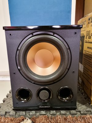

Coming to the subwoofer, 12 inch front ported design with 350 watt continous RMS power and peaks at 1400watts. On paper it goes down low to 15hz, but does it really go that low? More on that later.

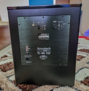

The subwoofer frequency can be tuned, not through app but through port plugs and switches. One form plug insert is provided and a switch in the rear, bass boost or max output.

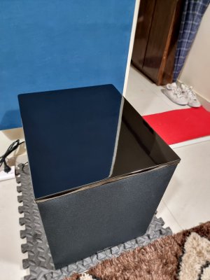

It is finished in Piano Black like on top and veneer on sides. The top does look very good almost mirror finish but is a fingerprint magnet.

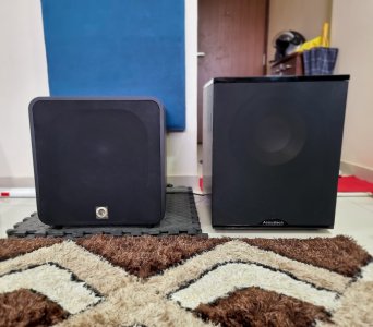

To test the claims, I did a REW measurement of this subwoofer using UMIK one in my room with my system.
It did close to 16hz in both Bass Boost and Max Output which is surprising, I wanted to take more measurements but Neighbours came home asking me to turn down, I was watching Dune earlier, which is known for very very good mix.
Coming to how this sounds and performs, this is a excellent subwoofer for the price. Goes deep, rumbles and thunders with enough tight bass. Not tight as sealed ones, or more expensive subs but enough to keep users happy or annoy neighbours.
It is quite powerful and never clipped or bottomed out. Remember the issue with the old PL 200 port chuffing or loose ports, this is sorted out in the PL 300 but because this moves a lot of air, and I mean a lot (I can feel my pajamas moving in room without fans turned on) the grill causes some chuffing type noise. This was audible only at reference volumes and scenes with lot of bass and low end, solution is to remove the grill and keep it aside. Don't know if it is me but it sounded tighter.
This subwoofer superb for Movies and ok for Music. The tightness and fast bass which one expects from a musical sub isn't there at all. Wouldn't recommend this to be used for music.
Having owned QB12 in past which is in the same range of PL300, price wise. I would recommend QB12 for music anyday, it is brilliant. Gels so good that the subwoofer disappear. Thumps, tight and fast.
But when it comes to movies, PL300 is in another league. The punch and the low end needed by the subwoofer for movies lacks in QB12. PL300 does all this without breaking a sweat.
