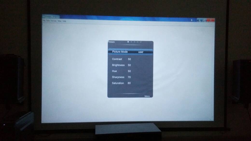

Here are my picture settings.. As mentioned before, i use picture mode "user" with tweaked values in Projector and also use "ISF Day" preset on my AVR..

Great Job.. Pictures look great.. I will also try these settings and see for any improvement for my room..
I had reduced brightness in the PJ, as the picture mode in the AVR brightens the dark scenes..

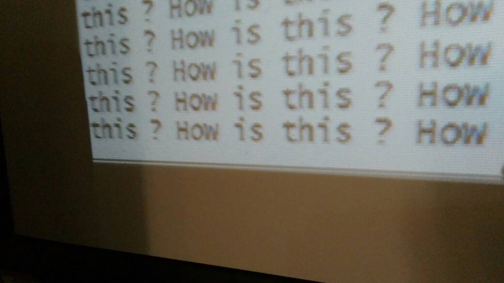

Do you also observe significant out-of-focus (for text) at the screen edges?

Since you have asked this question in both threads I am replying to it there as it seems to be your main projector set up thread.
Before I answer i just noticed in a an image above that you have set the RGB values to 100. Is it still that way? As this is going to cause major colour clipping.
Regarding edge sharpness, things to check before blaming the projector would be
1. Is your wall perfectly flat, in my experience they never are, however this isn't a major factor as your projector is not a short throw.
2. Is your projector square with the wall or are you performing more than ideal key stoning (ideal would be just 10 pixels at the max on a single corner)?
If your wall is flat and the projector is square then its going to be down to the projector lens (being a 1280x800 projector has nothing to do with the optics). The only solution you have at this point is to make a slightly curved screen to make up for the edge focus degradation. Should be fairly easy if you use a pvc foam board.

As said by danielnaveen2003, the issue has to be either of the two points.
Mine too had this issue, after focusing, if right side corner text was sharp, left bottom corner went unsharp and vice versa. Found that height adjustment screw is very clumsy, it moves one thread up or down where I want it to be. Using keystone button resolved the issue.

Plenty of setup tweaks have been done.
Majorly-
1. PJ is setup on the ceiling now.
2. Screen fixed (8x6' screen - the cheapest available with pull-down option, without auto lock for about 3.5K INR)
3. Some tweaking with the display profiles to get the sharpest image/videos.
The screen setup:
Screen is mounted about 1' 8" from the ceiling.
Ignore the waves here, they can be minimized/eliminated by adjusting the weights on the ends.
The projector is mounted about 3.5' from the ceiling.
The text clarity / focus uniformity check test:
Right-bottom:
Right-top:
Left-top:
Left-bottom:
Overall text sharpness:

I think the text towards the corners of the screen are sharp enough to read from a 10 feet distance from the screen..
Off Topic - Why have you mounted 4 speakers over the screen ?
Yes, the text is clear enough to read from 10 feet distance.
