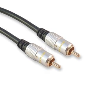

And what about left, right, and center channels and sub? Which cable should I use for that?
Well, other than the sub, you have to use the same speaker cables.
For the sub, you have to go with a RCA type cable. Connect one end of the RCA cable to the AVR's sub out and the other end to the LFE/R in the sub. Also set the "Use As LFE" to yes in the back of the sub.
RCA cable, something like below...
