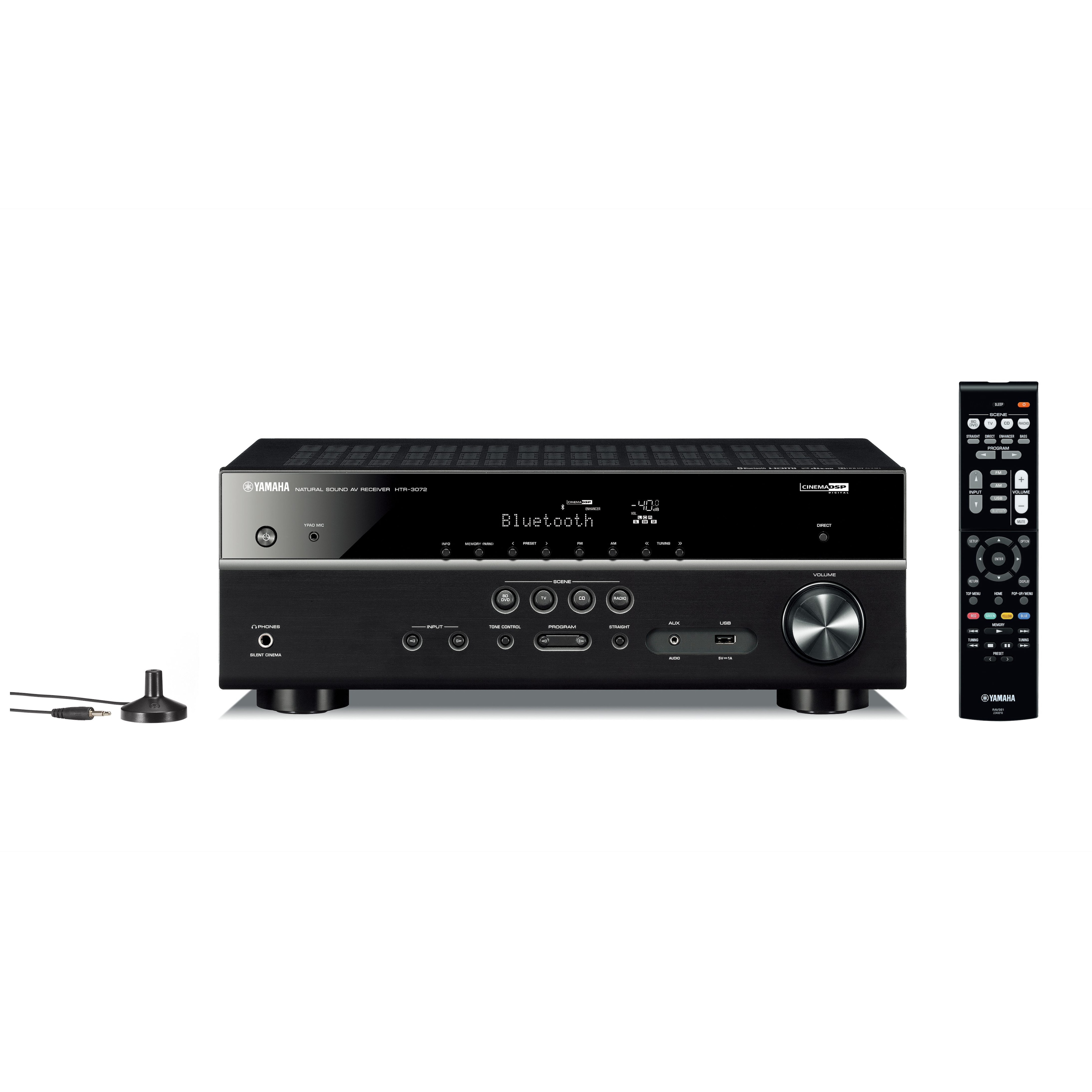

As I am trying to setup my tidal account and get the best music out of it. I just checked my avr and its specifications say that it only supports upto 48 kHz.
Attached is the snapshot of the specs I am referring to. Does this mean anything higher than that is not supported on my avr?
Unfortunately I'm very new to this and if I had known about this, I would have definitely gone for a better avr as now i am stuck with it. Dumb me :(Screenshot_2021-04-21-18-25-43-06_df198e732186825c8df26e3c5a10d7cd.jpg
If I use direct mode does it mean it is like an audio passthrough and then the speakers can play at higher than 48 kHz?

Wow, for some reason Audirvana is able to play 96khz on my avr and setup through my windows pc...
same track on tidal windows app plays 48 khz only.Wonder how come this is happening as technically my avr is supposed to be restricted to 48 khz only.
Have checked on multiple tracks and in signal info it is clearly showing 96 khz. Even for 44.1 tracks, Audirvana is able to play at 88.2 for me

My crown xls 2502 is restricted to 48 Khz. But the Zen Dac driver shows that Tidal is playing 96Khz. Your output frequency will be limited by your amp. But it not a big concern as very few will be able to tell the difference between 48Khz and 96 Khz.
But the avr itself is showing 96 kHz in the avr signal info. Have checked on tracks and it accurately reflects the signal. Khz its playing, so I guess yamaha advertise a lower strength but the actual system is capable of a bit more
