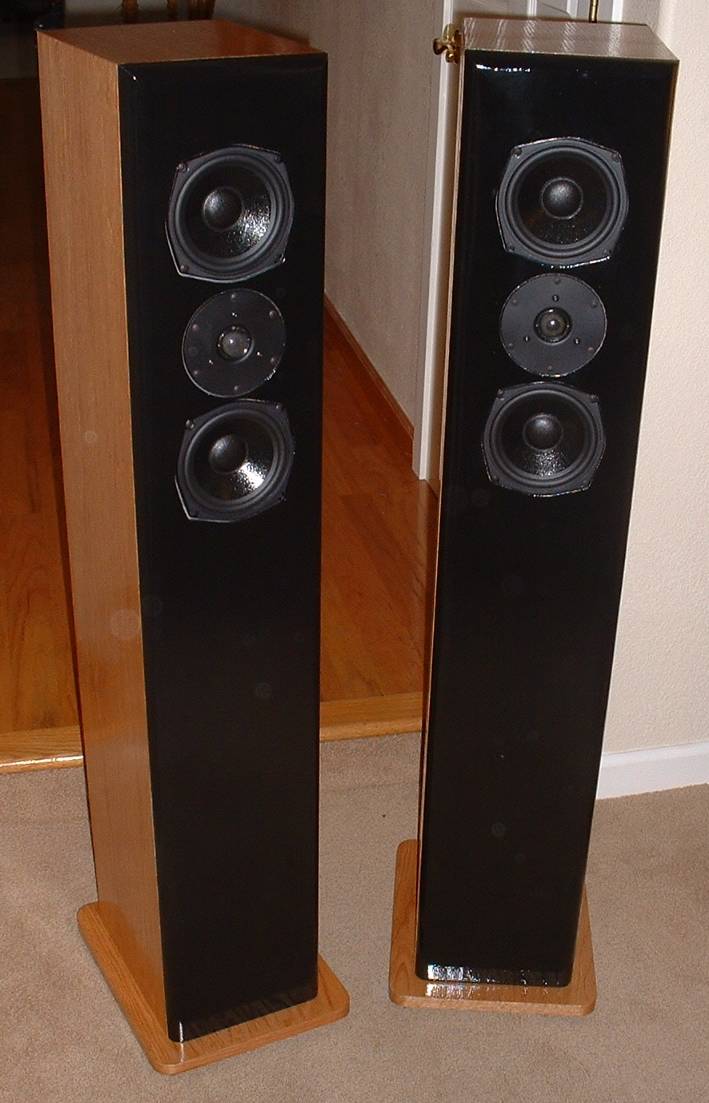

2.MTM pair under 10K
Parts Express MTM "components " kit in $119.99 =5200Rs
for all the drivers for pair of speakers
TriTrix MTM TL Components Kit
