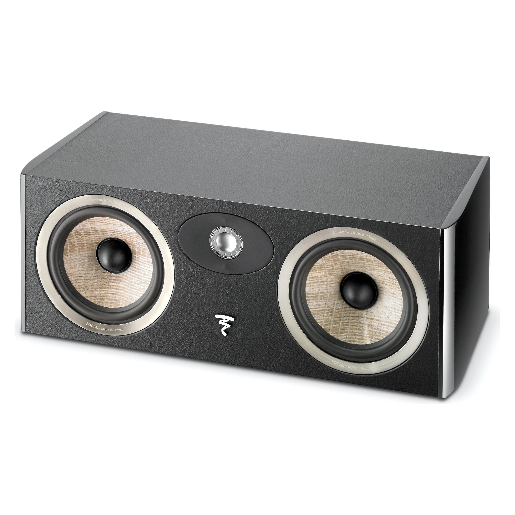

Now I am looking for surround experience. 7.2 channel. Please suggest me how to go about it. My plan is to get the following :
Aria SR 900 surrounds for side and back
PB 3000 as second sub
Now the problem is that I am unable to get Focal Aria Centre channel!
Can someone please help me finding a matching centre. I am looking for similar sound stage and similar timbre/tonality. Which center channel fits my need? I have few in mind but I don't know how they will go with Focal. Paradigm C600, B&W HTM 71-S2, or Klipsch or KEF.. ??

Well you are better of getting a Center speaker from Focal, a series below or above the Aria would be fine & a close fit.
Since the Aria 926 has 6.5" drivers, it would be better to get a Center Speaker with similar size drivers.
The Center channel is the most used & most important in getting an immersive home cinema experience.
Cheers..

Y are you not able to get focal matching centre...since it's not mentioned in ur post.
What are the room dimensions?
You may wanna hold on to the 2nd sub plan for now and finish the centre + surrounds first.
Since u hv Focal Aria 926 try to get CC900 only or higher. As it's best to hv Fronts + Centre match.

Excellent! I am in love with Focal sound. The whole setup is like this..
AVR Denon X4700h
Focal Aria 926 Front Left and Right
Focal CC 900 as Center channel
Focal Aria 906 as Side Left and Right
Focal SR 900 as Back surround Left and Right

Congrats 🎉 on the CC900
