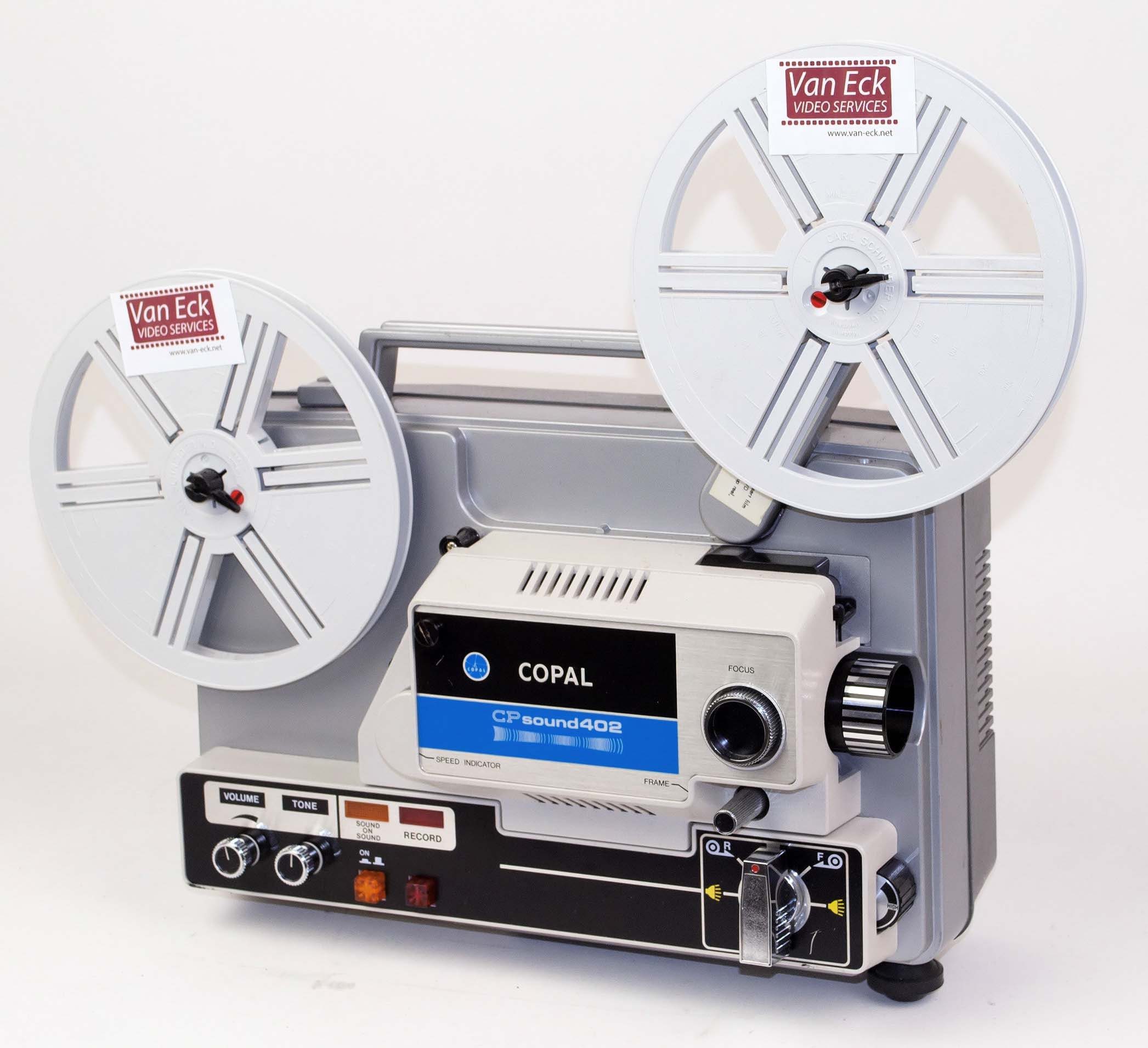

Drawing special attention to vintage equipment lovers and gurus. My in laws had this stored somewhere and sent it to me recenty. To be honest even for me it's a device from a previous era. I know it's a 8mm reel projector. A website called Van-eck has these details:
Copal CP Sound 402
super 8 mm film
lens: Etalon Super Zoom f: 1.3 F: 15-25 mm
lamp: 100 W, 12 V, EFP
reel capacity: 180 m
projection: forward, reverse
projection speed: variable speed control 14-25 fps
film loading: automatic threading
sound: magnetic playback on main sound track
sound mode: mono
amplifier: transistorized
amplifier output: 3 W (8 Ohm)
recording: magnetic recording on main track
sound-on-sound: yes
recording level control: auto
input terminal: Microphone, Phono
input jacks: Mic: mini jack; Phono: 5-pin DIN (European type)
output terminal: Earpnone, External Speaker
output jacks: Ear: mini jack; Ext Sp: 2-pin DIN
built-in speaker: yes
built-in film cutter: yes
motor: magnetic motor
power source: 220 V AC, 50/60 Hz, 150 W
weight: 8100 grams
dimensions: 260 x 280 x 330 mm
made in Japan by Copal
https://www.van-eck.net/itable.php?lang=en&size=&type=CP Sound 402&merk=40&cat=film
Which brings me to the important question - should I attempt restoring it (I don't know if it works, haven't switched it on yet)? Who can help me figure it out? A step by step process to go about checking and making it work (subject to views on the first part of the question).

OK! I have good news and bad news!
Good News: I connected the power and a light came on, so at least it was not konked off and could work!
Bad News: I moved the FW/RW knob to see what happens and BOOOOOM!!! smoke everywhere from behind the unit! And now I guess its konked off. So this is now a real restoration project.
I immediately unplugged the mains and after the smoke settled (weird smelling) opened the back cover to find a blown capacitor (I guess). A ruffled mess of yellow-brown paper with a metal strip was recovered from the vicinity of a loosely hanging capacitor casing! Before the BOOOOM! I could see the lamp lighting up - it was just a matter of 5-10 seconds. I don't know what else could have gone, but nothing else looks blown or spoiled. Strangely, there is no black soot or any such thing.
