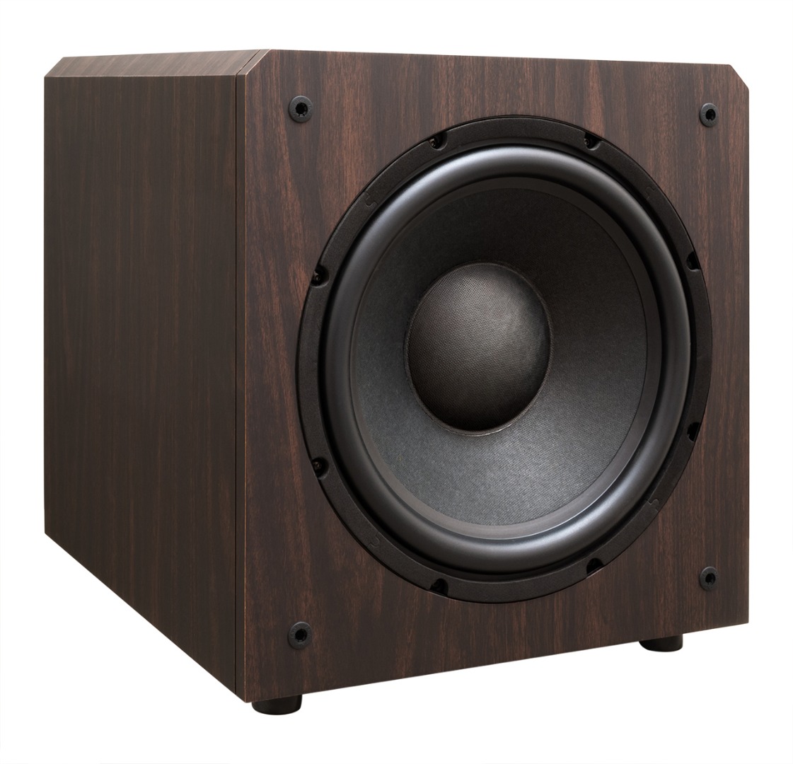

Taga SW212 sub
TAGA  Harmony
HOMEPRODUCTSHOME SPEAKERSBY SERIESAUDIO-VIDEOTSW-212
TSW-212
HOME SPEAKERS
SUBWOOFERS
TSW-212
Description
Specification
Finishes
Technology
Downloads
DesignActive subwoofer, 1 driver
TLIE enclosure
Amplifier power200W RMS
600W Dynamic Peak
Class A/B
Frequency response25Hz - 200Hz
BassreflexSingle, rear, slotted
Bass driver305 mm (12”), paper
6ohm
Crossover filter frequency35Hz - 150Hz (variable)
Phase regulation0°, 180°
Inputs1 x Line-level (L/R)
1 x SUB (LFE)
1 x High-level
Features / accessoriesAuto On/Off
Single RCA-RCA Subwoofer Cable
Removable IEC power cord
AC power / power consumption220V-240V 50/60Hz, 200W
Dimensions (H x W x D)40.2 x 37.1 x 42.5 cm (incl. feet)
Weight24.2 kg / pc.
