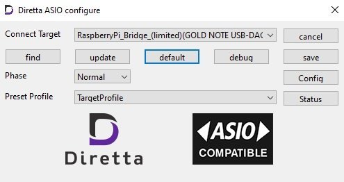

7. Now install the DirettaASIOdriver_2_143_2 file in the laptop. After installation, run the Diretta ASIO Configuration file (you can search for it in the windows search button). When it opens, click the Find button and then the Connect Target drop down menu to select the raspberry pi as the target. For additional settings, you can click the Config button and see.
8. If you have successfully reached till above, then you are all set to play music files

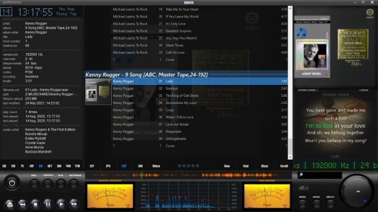

9. Install Foobar and install ASIO component from its repository. You can download the ASIO component for foobar from the link below and install it. https://www.foobar2000.org/components/view/foo_out_asio
10. Once ASIO is installed, restart foobar (it will normally start automatically). Now if ASIO component is properly added, in the Device Output option (under Library/Configure/Output), choose Diretta ASIO as the output. You can also set priority to realtime in the ASIO Setting option.
11. Now import your playlist or select the music files of your choice and play and experience Diretta.

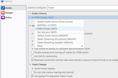

12. If you have installed JRiver, so dont need any add-ons, under Output, choose Diretta ASIO.

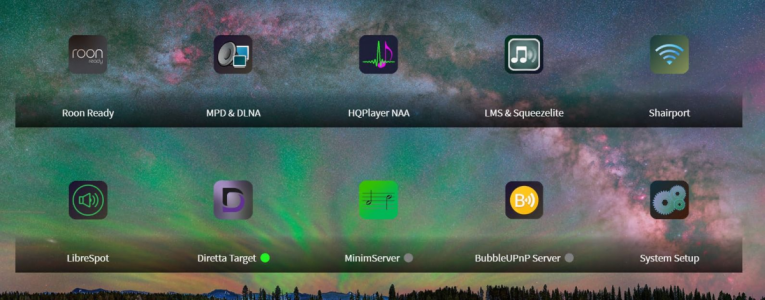

How I run Diretta with the SOtM sMS-200 Ultra Neo:​

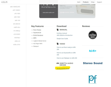

  • Install the SOtM Diretta Host Driver on your host PC (this is the same PC you use for playback—Roon, Audirvana, HQPlayer, etc.).
    Driver link: SOtM ASIO Driver
  • Ensure IPv6 is enabled on both the PC and the SOtM device. (how to enable on windows 10/11)
  • Connect your DAC to the SOtM (Diretta Target), and make sure the DAC is powered on.
  • On the Eunhasu interface of the SOtM, enable Diretta (make sure all other protocols are disabled).1754512434228.png

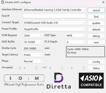

  • Open the Diretta ASIO driver on the host PC, click Find, and your DAC should appear. Select it and click Save.1754512418561.png

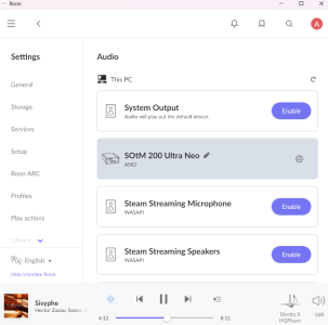

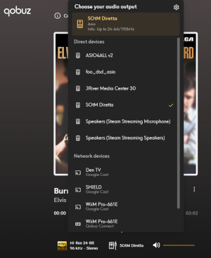

  • Now, in JRiver, Roon, Qobuz or HQPlayer settings, the SOtM Diretta device will appear with the name you assigned to the Target device. Just select it and hit play.

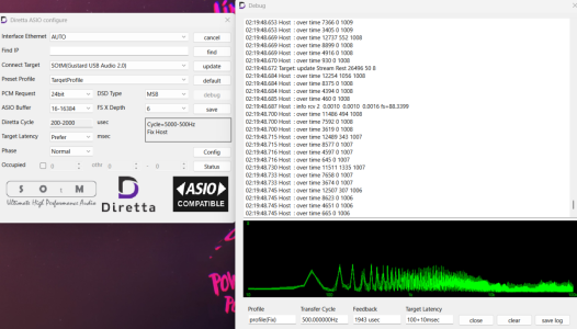

  • To check if Diretta is actually working, you can use the Debug Tool under Diretta Control Panel, it is a handy tool.
    You can check and be used for Low-level system tuning for ultra-low jitter audio streaming by making changes to the config files or in the control panel tab.

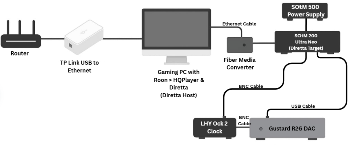

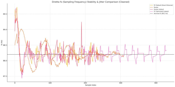

I have gone one step further and connected my Diretta Target to Host via ethernet (SOtM connected to PC directly) to reduce latency and jitter.
Below is a diagram showing how my digital chain looks now:

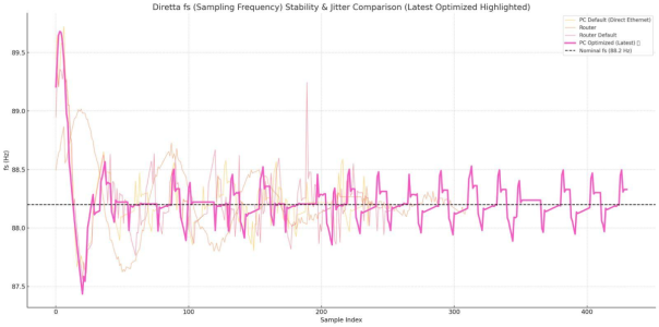

Before and After optimizing chain for Latency & Jitter:

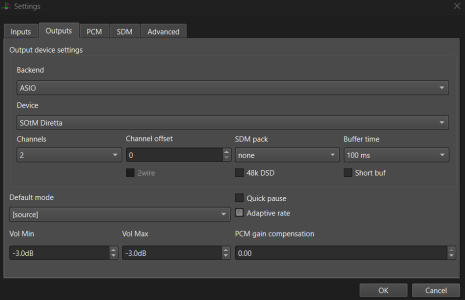

Jriver
Qobuz
Roon
HQPlayer

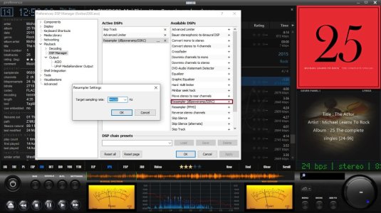

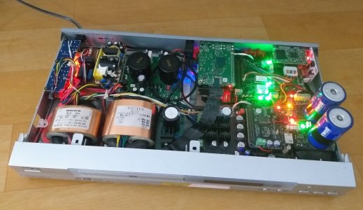

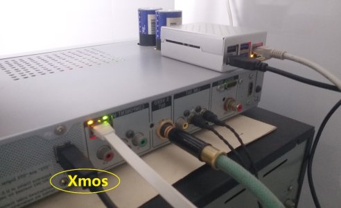

Thanks Kannan for sharing how to connect diretta (Raspberry Pi 5 limited simple) simply, effectively, stably, easy to use .:eek:

Hardware:
1. Raspberry pi 5
2. Laptop or a PC running Windows 10 or 11
3. USB to ethernet adapter (Optional), You can also use your laptop’s in-built ethernet adapter
4. An ethernet cable (preferably crossover cable) to connect the raspberry pi directly to USB/ethernet adapter connected to the laptop
5. USB DAC is mandatory

2. Connect the USB cable between the USB 2 port of raspberry pi and the USB port of your DAC and power on the DAC and select the input option as USB in the DAC. If you DAC has a display, it will show a connection established.
3. Insert the SD card into the pi 5 and power it on. When you see both green and red light lit-up after a minute or so, it means the pi has booted successfully.

6. Next run an ethernet cable between the above used ethernet port (IPV6) of your laptop and the raspberry pi’s ethernet port.
Here is a schematic in its simplicity
Hope this helps.
