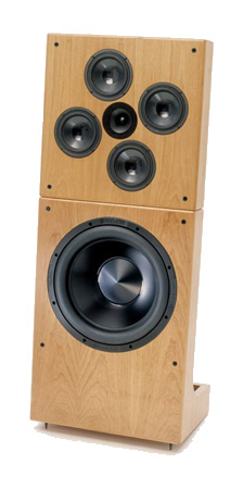

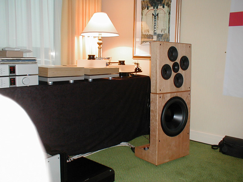

In my case, Id like a 8/10/12 coaxial driver to do duty in a flared cabinet with XOs at 60 to 100 hz(with stereo subs) and the second one at 1000-1600 hz(between outer woofer cone and inner compression driver), give or take a couple of 100s. Whats that between friends, eh? The 1/2 compression tweeter may be allowed to play just beyond 10 khz at max, in event of going in for a ribbon/AMT/bullet/slot tweeter for the highs.
I have done some research on (easily&locally available) drivers for subwoofers, mid-woofers, lower HF and upper HF drivers, most of them being from the "Thoroughbred Pro" stables, for very obvious reasons. Suitable brands for the coaxials are B&C, RCF, Eighteen Sound, Beyma, P Audio, Ciare, Faital Pro to name a few, in no particular order.
However, I confess that I am still in two minds whether to go in for a coaxial or for a large format ie 2 compression tweeter-cum-wooden/cast aluminium/ABS/fiberglass horn{ (18 or more across, if wooden) to play from 400-1200 hz to about 7-10 khz} surrounded by 4 x 6 Peerless/equivalent woofers to play from about 60 -100 hz to 800-1200 hz, as seen in these speakers:-
Legacy Whisper XDS
Legacy Helix
Donald North Sequence
Any pointers/ideas/suggestions/comments/opinions are welcome
(Flame suit on) :D ;)
After this I shall revert to the design aspects/driver selection of the stereo subwoofer drivers and cabinets (common for the LA and mutiway system but to be XO-ed between 150-200 hz with the line array). Above the subwoofer would be added subsequent components in their respective cabinets, as separate modules that can be stacked together to look and perform like one tall unit.
More on hearing from you guys.
