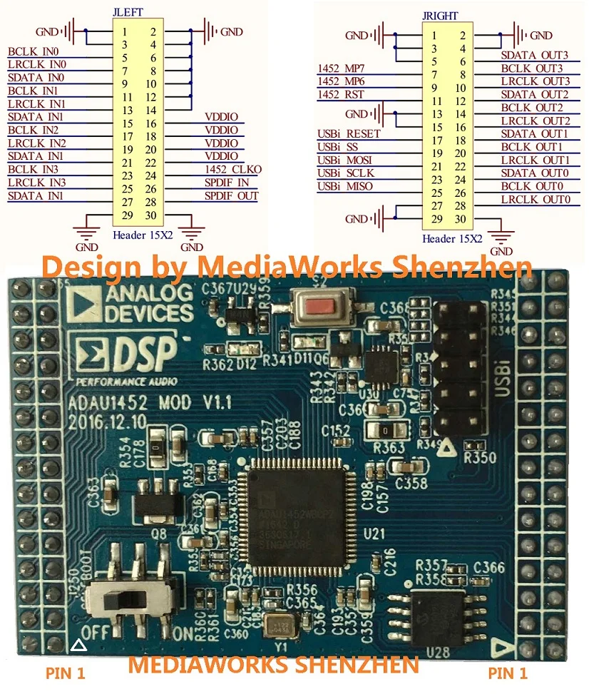

I have seen these cheep dsp learning boards in ali express but not much details about them is available, few sites mentions of making dsp based cross over with them but as totally new to this i dint understand any of those .i read that these processors can be programmed with sigma dsp software where you can build crossovers and filters using its GUI. Can some one give me directions of making a crossover with these .

Analog devices provides SigmaStudio to design filters using dsp blocks in graphical form. Pipeline of audio flows, routing etc can be done and flashed on to the board. There is no programming needed.

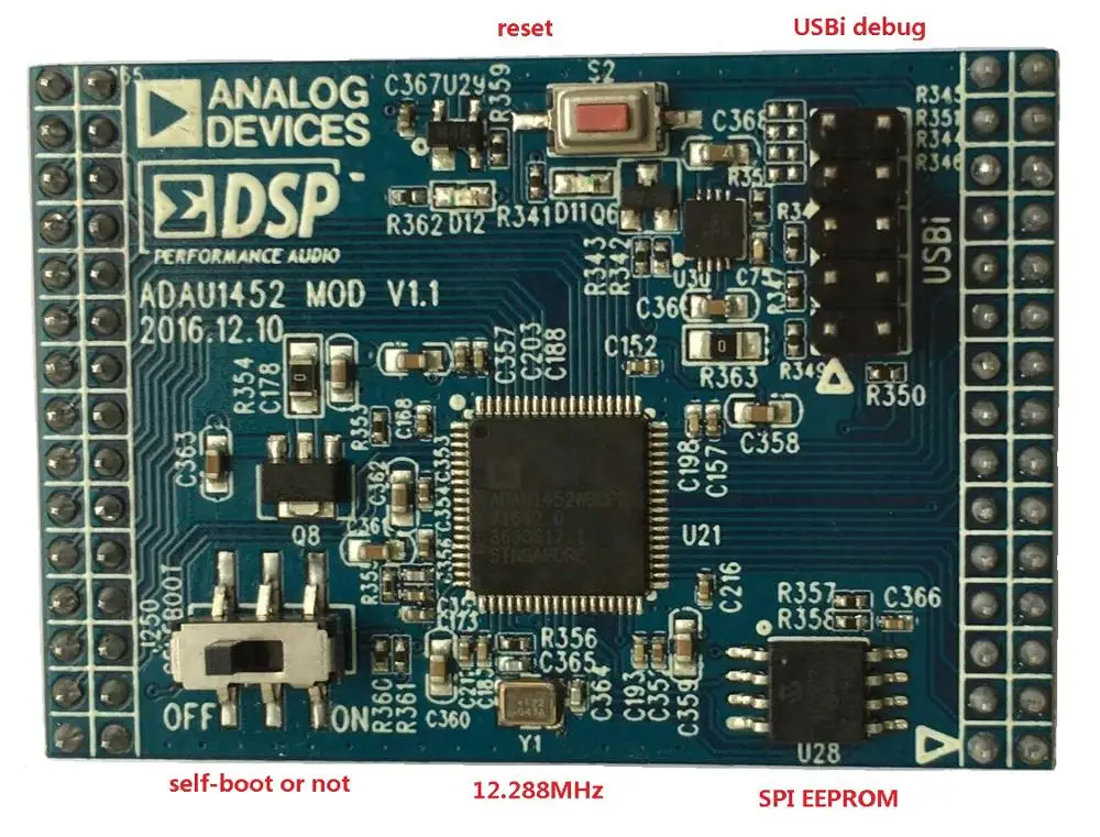

how to flash that to the first board i couldint see any usb interface ? do we have to solder a usb interface ?
and some where i read it wont store the program and it has to be loaded from a eprom do we have to attach another board ?
this one has usb , eprom but cant see any audio connectors
