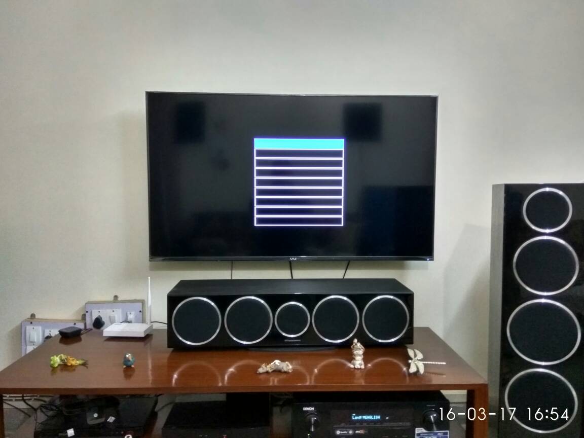

I have a problem with my avr. The menu is displayed in special characters.
I am attaching the picks

Is that the Denon's own menu that is not working? By STB menu, I would guess that the Input sources are all fine. Was there any firmware update recently? Did you try resetting the receiver? Do the buttons on the receiver and remote work? Also, did you try a Denon mobile app and tried to alter things around? Did that work?

Hi Krishna,
Do a factory reset and check....if same issue persists and the avr is under warranty, please get it fixed...most Denon models are known to pop up issues....

The firmware update could be the most likely cause as you stated.
i had a similar problem with the Denon X1000 and the culprit was the firmware done the previous day. i did a reset and the menu came back on .
on the display of the avr ( not the TV) does it show normal messages or an error ? if no error then proceed with the reset
steps to reset :
Press the " ZONE 2 SOURCE " and " DIMMER " buttons simultaneously while powering the unit on.
Do Note you will lose all saved setting etc while doing it and the units audyssey etc will have to be done again.

This is how I reset the AVR.
Turn off the power.
Press*power*while simultaneously pressing TUNER PRESET CH + and TUNER PRESET CH -.
Remove your fingers from the two buttons when Initialized appears on the display.
Do I need to do anything after I get the initialized message on the panel?
after the Initialize message after that it should cycle through the various settings on the avr display.
post that when i switched the tv on the menus appeared correctly.

also you can try using a video out port on the avr and see if the display comes when you play video through that and not through the hdmi. if its the same then you have a different problem.
just checked on denon site and found this :
The menu screen is not displayed on the TV
The menu screen or status information screen is not displayed on the TV.
The menu screen is only displayed on this unit and a TV connected with an HDMI cable. If this unit is connected to a TV using a different video output connector, operate while watching the display on this unit.
