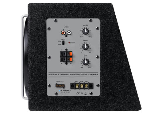

Which sub do you have? Can you post a picture of its rear panel. If you have speaker out on the sub then your Job is easy. If not then you need to do some juggling. Next easier step would be to use A and B speaker channels on your stereo amp.

It is a car sub. Blaupunkt GTB 8200 A. Since it is doing almost no duty on the car planning to use it to complement the stereo speakers for low freq. The rear panel has high level and rca input.
the LJM L15D is supposed to output 250w at 4 ohm. the subwoofer amp is rated 100w. is it safe to run the speaker out of the amp to the high in of the sub. or use a preamp to Rca Line in of the sub.

you can't use speaker output on this sub [if you do, you'll end up feeding only the sub from amp: you can't connect your speakers after that].
your best option is to use a quality Y splitter after preamp. i use MX ones, it serves the purpose perfectly.

Oh that makes it even more difficult. How are you going to power it?
What is your source? You can try adding a Y splitter at the source's RCA out and send one line to RCA Line in of the Sub and other line to the stereo amp.

speaker input on that sub is meant for highlevel input - usually off your car's HU and i've not come across any example of feeding amp input - might work for amp input too. you can as well split the RCA out of the HU in that case.
on the other hand, few home powered audio subs have provision to pass the speaker output through the sub - sub is in series between amp and speakers. it would only 'read' the signal passing through it.
High level input is direct from car speaker output and the RCA input is for sub out/pre out. that is how it is currently connected and i am clear about it.
My basic doubt is will the existing stereo preamp be able to run both the sub and the stereo or a seperate stereo preamp will be needed. i have two spare preamp board. will check it out tomorrow :)
