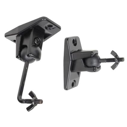

Ok thanks for the response. Have u installed them on concrete ceiling? If so how? And also can you post images if u don’t mind just to get an idea
Yes on concrete cieling only. There are speaker mounts available for owm 3. Google for perlesmith speaker mount in amazon.com. I use similar ones.
