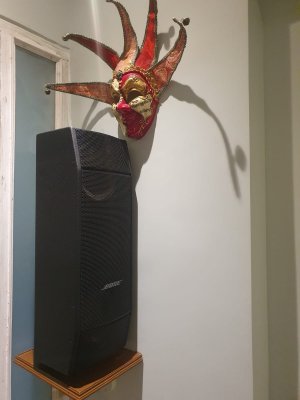

Lets just say I got lucky with these.
Yes the denon has preouts for the PA. I did look at crown and a yamaha PX3 , not sure though if its the right choice. Willing to invest in a better more suitable PA option if recommended.
Yes everything vibrates in my living room, but I haven't really been able to test them (amp gone for repairs). The sound is crisp and LOUD and it works, just need the right amp and a 15 year old amp like you mentioned, is just not convincing.
