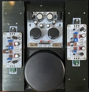

Last night first time testing.
setting about 30Minut to 2 hours
DCO 0,02v dc hard
Driver D756/B716 •@ 8,xx Volt
SB754 @ 0,560
SD844 @ 0,630
trying adjust trimpot 1K hard to get balanced
Small Heatsink @70 degrees after 1 Hours
Xformer 12Ct 50 degrees temp and drop to @10volt.
PSU Cap Multiplayer TR C5200/A1943
•sound notyet test.
•using original schematic and input Tr Gr version.
it is normal with heatsink hot 70 degrees? … or I have doing wrong setting
pls advice me thanks
sory newbie’s
