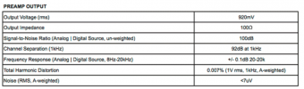

I have an integrated amp which has a pure class A pre amp section with sensitivity on 920mV which I am planning to use as a pre-amplifier to drive my speakers.
Below is the specs for the preamp out:-
Need some suggestions as to what numbers in Power amp should I be looking at to match the above mentioned preamp configurations?
alongside, would be great if some suggestions can follow in too.
Happy diwali in advance.. Cheers :)
Hi Kumar,
Your preamp will drive most Power Amplifiers, even though the Output Voltage is a bit on the lower side.
Just make sure that your Power Amp has an input sensitivity of 0.92 Volts ( ie 920 milli Volts) or less... eg 0.77 Volts input sensitivity will be even better.

Thanks @IndianEars for a detailed yet easy-to-understand explanation.
My takeaway from this is that I need to look for the a PA which is <1V input volt.
Any suggestions on the PA with this specs?

Yes, you are correct that you need to buy a Power Amplifier with an input sensitivity of <1 Volt. More than 80% of power amplifiers will meet this specification.
However, there are other Far more important criteria to select your Power Amplifier. These Include:
  • Maximum Power Out ( Ideally linked to the Speakers you will use and the Room Size)
  • Solid State Or Valve (Each have their strengths and sonic signatures)
  • The Sound Of Your Power Amp. (Every Power Amp Sounds Different and you want to pick a Power Amp that in conjunction with your Speakers, delivers the "sound" ie Tone, Dynamics, Resolution, etc that you like. )
If I may ask, which Pre-amp are you referring to ? Have you already bought it ? Maybe you can consider an integrated amplifier ?
