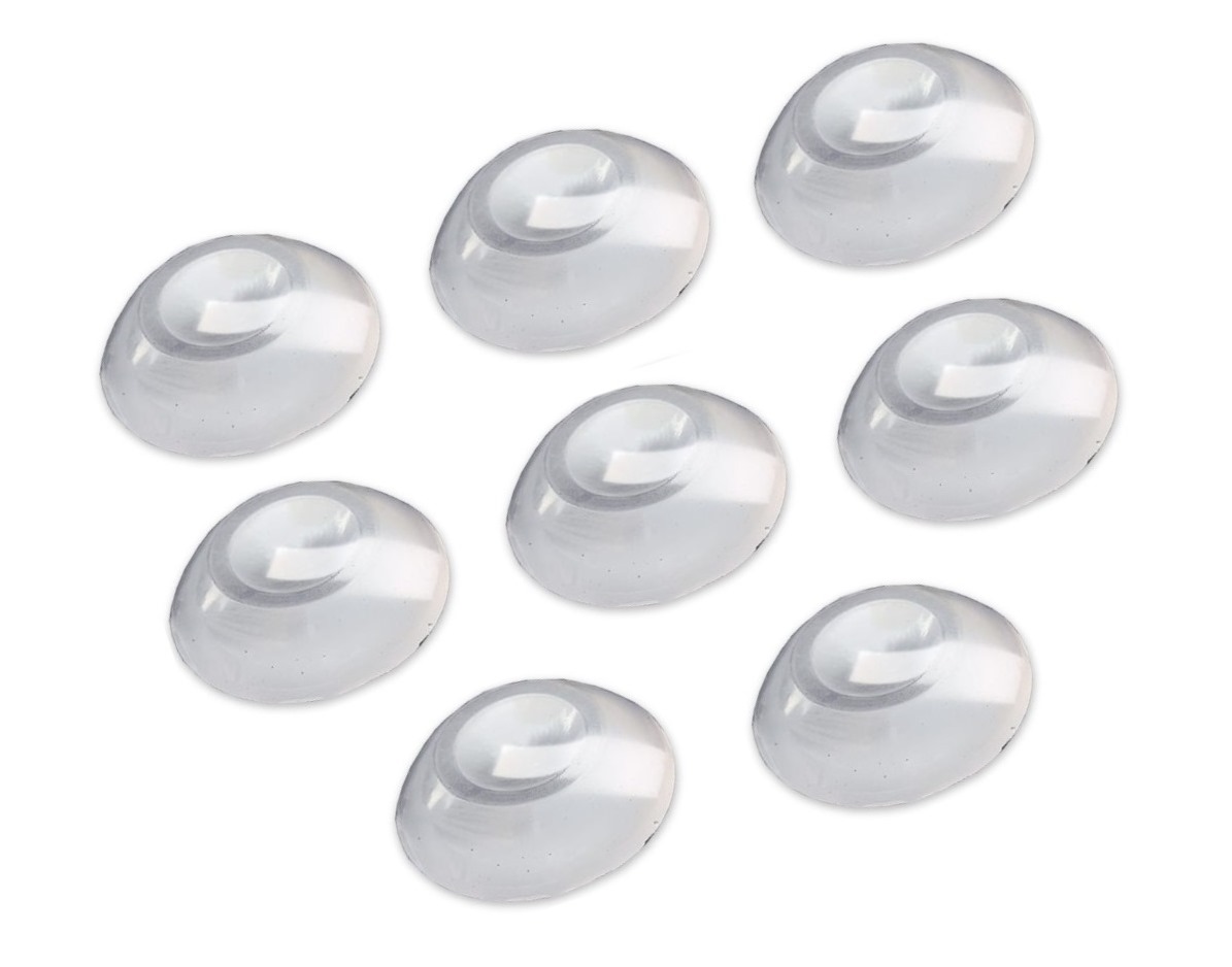

For isolating qa 3030i placed on a tv cabinet (until I get the stands)
pods or foam pads
Or
