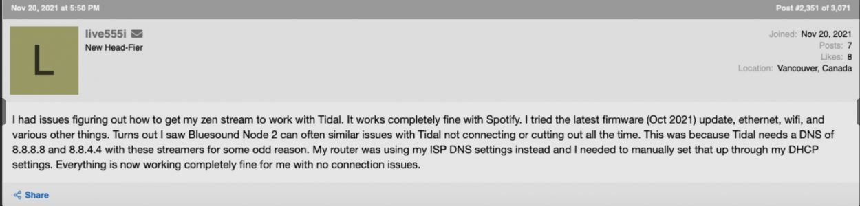

At last I was able to fix the issue with the help of one of our FMs Gecko.
Tidal connect work with static ip adress in the router. In addition the DNS setting in the ifi app to be changed as follows,
DNS Server 1: Enter 8.8.8.8
DNS Server 2: Enter 8.8.4.4
After these changes Tidal connect works perfectly in Ifi zen stream
