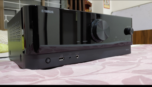

Finally the beauty Yamaha RX-V4A has arrived. A friend brought this for me from Tokyo, Japan.

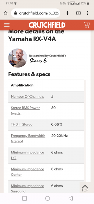

Minimum impedance for all speakers is rated at 6 ohm for Yamaha RX-V4A. Wharfdale Diamond is rated at 8 ohm nominal impedance and 5 ohm minimum. Technician at Wharfdale dealership confirmed Yamaha-RX-V4A would not have trouble driving them. Please advise if I am wrong.
At normal listening levels it should be able to drive them but at loud levels the amplifier might have a hard time.

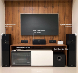

Alot depends on the placement of the speakers be it the L/R speakers or centre or even the surrounds. Placement brings about the biggest change according to me over purchase of newer and more expensive equipment. A centre speaker and subwoofer play a vital role in delivering the HT experience we imagine in our minds at the time of purchase.
Can a 2/2.1 channel setup be sufficient for movies? YES
Can it better than a well setup reasonably priced HT? NO
I donot intend to critise the above setup knowing it belongs to someone but using it to clarify a few things and answer a few questions. If it in anyway is against the rules, mods please take the necessary action. Thank you
What is not right in the above picture? I am sure to many people going for a demo/ making their first HT purchase this would look ideal. Neat looking, space well managed, organised.
Before anybody goes ahead and criticises the sub placement, one of the best experiences i had was from one setup in a similar manner. A flat straight line from 60hz down to 14hz from a 10 inch woofer. And the impact and feel was surreal to say the least.

Yamaha will drive wharfedale easily. I had RXV667 once paired with Diamond 9.5. Yamaha AVRs can handle short term 4ohm load which is stated in manual.

Minimum impedance for most of above speakers is 4 ohms whereas Yamah RX-V4A expects minimum imepdance to be 6 ohms (screen shot attached). Please correct me if I am wrong.

Should'nt have any problem with Q Acoustics, average impedance is 6 ohms , this is also known as nominal impedance. You only need to try to match the nominal impedance, not the minimal impedance.

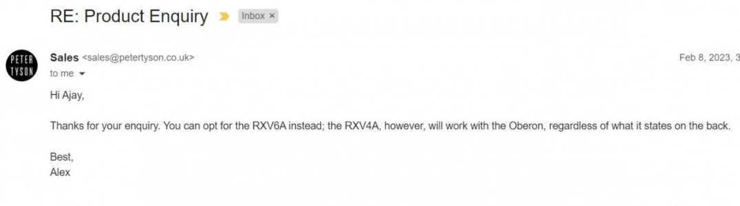

Some UK sites are even selling bundles, which obviosuly would have been tested to work together, see below:

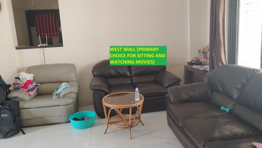

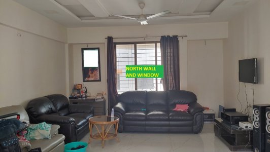

Hello FMs,
Thanks you for your comments.

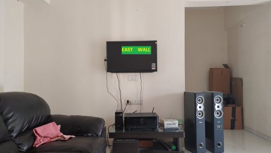

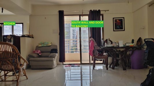

I have attached pictures of my living room. My living room is the primary choice for the 5.1 home theater (a bedroom being secondary).
Some points to keep in mind (pictures of living room attached):
  • Living room size (wall to wall distances) - East wall to West wall 13.5 feet. North Wall to South Wall 20 feet. East wall is where I want to mount a 55 inch tv (Sony X7500H) but can mount on west wall also.
  • This is a rented flat so please suggest changes accordingly.
  • In future if I move to another flat chances are the living room/bedroom size will only get smaller as compared to this one.
  • Wife approval factor is high. She just wants me to get the system and stop watching/reading the reviews.
  • I want to purchase speakers (at least front L/R) keeping 10 years in mind. My earlier budget for front L and R was Rs 30,000 but now I have increased it to Rs 1 lakh for front L/R.
  • Yamaha RX-V4A would be fed with audio from Sony X7500H over ARC HDMI port (100% times for movies/series and 90% times for music from YouTube or Spotify)

  1. I have learnt if I setup the 5.1 HT in my living room (which is 270 sqft and open on almost all sides), my appetite for bass may not be satisfied with one subwoofer such as SVS PB1000. For next 5 years I do not see myself getting more than 1 subwoofer purely due to the budget.
  2. If due to this limitation I have to shift the HT setup to bed room (10.5 feet x 13.5 feet not as open as living room), then floor standers would not be suitable. If I go ahead with bookshelf speakers, I would not get the kind of bass I desire in stereo.
  3. I want to feel free while listening to music (can move around in my living room). For movies I can sit at one place in my bedroom i.e. on the bed.
  4. I may compromise on surround effect and use zone A for stereo in living room and zone B i.e. 3.1 in bedroom or I can get a cheaper pair of bookshelf speakers later on for surround and physically switch speaker connections to AVR each time I want to watch movies (which an be last resort).

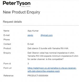

  5. As per specifications Dali Oberon vokal has a nominal impedance of 4 ohm. Center channel would be busy 90% of the times during movies. Yamah RX-V4A expects minimum impedance to be 6 ohm. Would this be a safe to run oberon vokal with RX-V4A? I auditioned a setup at AVXcellence, Dhole Patil Road, Pune in which Rx-V4A was driving oberon vokal.
  6. I found this bundle being sold by Peter Tyson UK which claims Dali Oberon Vokal can be driven by RX-V4A (screen-shot of my email query and answer attached)
  7. To audition more speakers such as Wharfedale Diamond 12.x series I would need to drive to Mumbai with my AVR which would cost me around Rs 5000 and lot of time. I have a little hesitation in doing that but that is in my list.
  8. If Dali Oberon Vokal's impedance is a major issue I can also use Dali oberon 1 or 3 as center channel (single piece can be bought in Germany, a friend can get that for me).

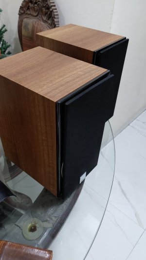

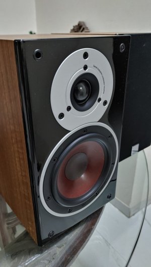

Added a pair of Dali Zensor 1 as front L/R for now. They sound good but seem power hungry.
