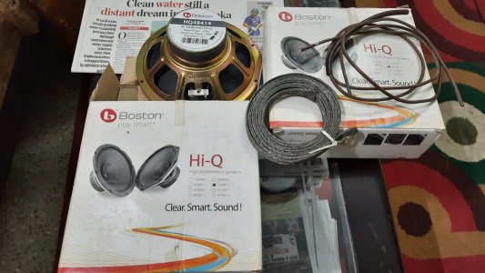

For the tweeter I have 1 inch 40 watt Peerless Silk Dome. (This is already in a pair of bookshelves and it sounds amazing.). I also have a pair of Danity 1 inch silk dome tweeters All 8 ohms.
For the mid of the full range part of the 3 way I have a Boston 48414 40 watt RMS 8 inch 8 ohms.

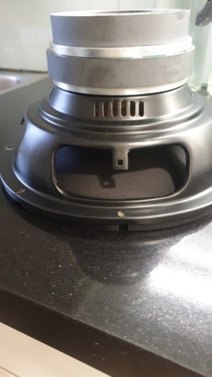

For the woofer I have purchased Sweton SBS 10 inch double magnet.

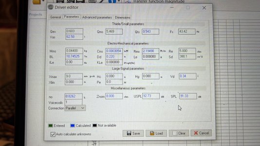

I have all the TS for these speakers. And would like to thank Sweton for all the help provided. They really went above and beyond in answering all my questions.

So one of the speakers donated to me was a bookshelf which consisted of the Same Boston 48414 with the peerless speakers.
To be honest I have never heard anything that sounds so good. Its even better than my Bose Book Shelf Series II speakers. Way better. The only problem being that these bookshelves have zero bass. Hence the idea to add a woofer to get some base.

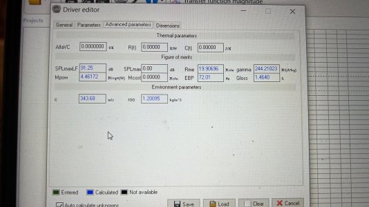

I have the basic data entered up in winisd and I have been reading up.

Have hooked up the 10 Inch Woofer 150 watt to my system without a box.
As it was 150 watt and my other channel was playing just a 40 watt bookshelf was expecting the woofer to be soft but funny thing it sounded just as loud as the 40 watt speaker in fact louder.
The other surprise was even though the Freq curve shows a shard drop off at 2000Hz it felt like I was listening to a full range speaker.

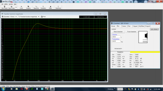

So far the best ported box size I could calculate for this woofer was 100 ltrs. Which is a bit to large for my limited. space.

The PDF file contains the data shows the range these speakers work best at is 42-2000Hz. Hence my question does it make sense to target a freq of 30 hz when my speakers dont even go there.
How do you pick the target freq of a box whats the logic ?. There is so much info out there on subs. But here is my catch 22 I love bass. But I hate subs. Or at least all the subs I have seen and heard. The music always sounds better with the sub turned off. Agreed my exposure is limited to a few friends setups. Nothing profesional.
I had a friend test them 10 inch and his screen shot pretty much matches the data in the PDF.

The plan for now is to make a single box just for the 10 Inch. So far my best curve is with 30Ltrs. I know this would sound better with a 90-100 ltr box. But space is an issue.
Plan 1 is to first build a sealed box 30 Ltrs. (Or maybe even an open baffle) See how it sounds and measures and then plan B is to add a vent to the same box and see how it sounds. Plan C would be to build a single box that would have tweeter, mid / full + the 10 inch woofer.
