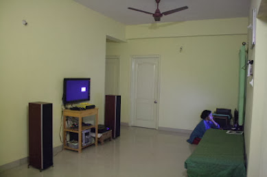

In the "Anything else I could try ?" dept. moved the speakers further apart, and closer to the back wall
and this is the current arrangement
rQiD369s76dAm2smmtjUlrGskni95eT0B5ciDgV0NTo=w389-h259-p-no
The SQ is vastly improved. It was a source direct only evening. I am sure there is um room for improvement but Eva, Roberta and Roger Waters assured me that there is hope yet.
The rubber wood table under the TV is not really necessary and is going to clear up the space between the speakers.

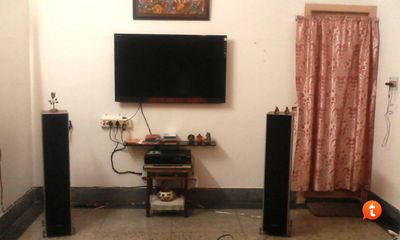

i have placed the Sonus 2605 very close to the wall as i dont have much space...
My room dimensions are 14 x 11.. I choose to keep it along the the 14ft wall (Width) as it would create more room for speakers
Here is how i have placed my speakers...

i too bought these speakers with the SiA320 amp during the discount. and i too have the same kind of room, 25'x11'.
i have placed my system on one small wall, firing away into the longitude of the room. the sound is just the kind of bright i like.
i suggest you try placing the speakers on your small wall and giving it a try. also, your room seemed too devoid of furniture.. try putting in some furniture to the walls between you and the speakers [on both walls] and a thick carpet on the floor. reflections make the sound bad at times [interference].
arrange the speakers so that the listening position and the speakers form the vertices of an equilateral triangle. the speakers should face you.
oh, and leave some space behind the speakers. reduces bass overhang. :)
hope this helps. if you have any questions, i'll be happy to help.
