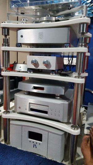

Below is the current chain.. And the lumin u1x is a new addition. The power supply is next to the MFA passive preamp. I don't believe in investing in cabling though I have seen different presentations with different cabling that I can't explain. But considering the amount of cabling a 4 way active setup needs... I presently want to let them pass. I will probably revisit this area again, once funds permit.
At the back of it all is some great cabling in terms of inter connects. As I believe that capacitance of a cable matters. But I don't believe in power cables whose sole purpose is to deliver current... Okay I will go put on my helmet and await the brickbats😊😊

Thanks nitin 😀.... Yeah it does look good. Would have been better if it sounded good too 😅. The cd player is a esoteric K-01. I plan on using it as a CD transport into the Deqx.
Most welcome Manu, all the components look solidly built & beautiful. I am sure they must be sounding fabulous as you must have carefully matched them :) All the best for your future acquisition.
