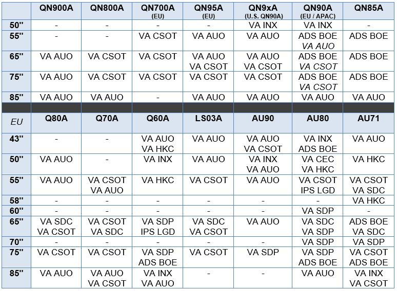

Actually it's ADS. In QN90A series and above only the panels that are marketed as Ultra Viewing angle are VA panel while Wide Viewing Angle are ADS. In samsung India site you can see for all the qn90a sizes except 85" it's mentioned as Wide Viewing angle. So atleast according to their website it's ADS panel and knowing how shady Samsung is with their marketting I don't think it's VA. Also there are some owners in reddit and rtings who claimed that it's ads panel.
50" is VA with no film
55", 65" and 75" are IPS/ADS
85" is VA with Ultra-wide viewing angle film
There is no 50" IPS panel in production. Only 49" IPS panels exist. Here's the whole rtings thread discussing that:
Rtings initially said it's an ADS panel, but later took back that statement.
Also here's the list of all variants with their panel types and suppliers
My bad. Then it's a relief. It could be a great gaming monitor. My sister is looking for 55" bedroom and 65/75" living room TV. For living room I convinced her for Mi Q1. Suggested Hisense h6g for 55", will suggest her to have a look at QN90a.
