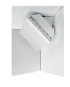

As for positioning, I plan to put them like this:
Would you recommend aiming it towards the listening area or towards the ceiling so that it can bounce off of it?

I think OWM5 is much better compared to OWM3 as it has much wider frequency range and better sensitivity. The range of human ear can only listen between 20-20000Hz, so anything below or higher is not heard. Any speaker with higher range will not be distracting, its just it will be more detailed imo.
As for positioning, aiming directly to listening area is preferable compared to bouncing off ceilings. And this speaker is made for such applications, and can be placed in a similar way as shown in the picture.
