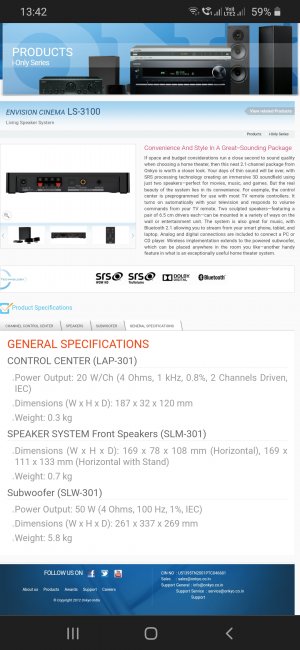

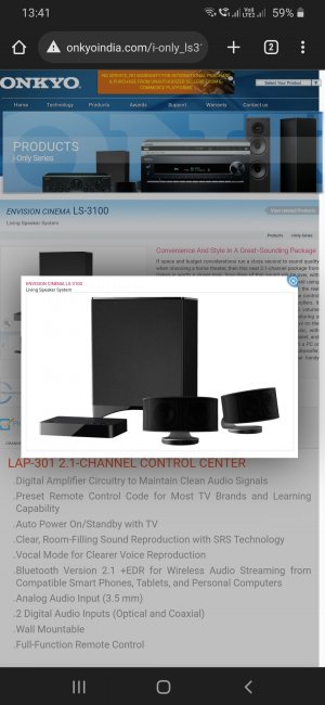

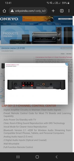

Hi all.
I have onkyo LS3100 2.1 home theater system which was working fine since 8 years. Recently the subwoofer stopped working. The onkyo service center said it cannot be repaired as spare parts not available.
Any suggestions who can repair it in Bangalore?
Since it is a wireless active subwoofer, can it be converted as wired active subwoofer and connect to the unit?

I think if the driver itself gone, them no way to repair. If any issue with power board or electronics circuit then it may be serviced.
You may try your luck in SP-Road bangalore. I have seen some shops who were having serviced AVRs .. but do not remember.

It can be converted to wired subwoofer using external amplifier
You will need to open the subwoofers and take out the wires coming from the subwoofer driver and connect to the external amplifier.
Try getting it repaired first if the repair cost is reasonable otherwise it is better to get external subwoofer amplifier for around 6k
