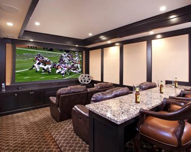

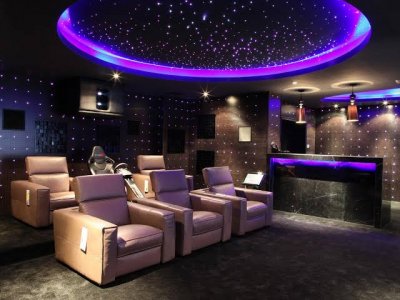

As for seating, I was thinking 2+3. There will be very less days when I might have a full house. 80% it will be only me using this area. Also, first thing I checked was how is the Internet, my neighbour has 40mbps plan, that was a major relief.
I agree with you regarding bar, people getting tipsy and fooling around. I also will be having a bar inside the pool or outside. So this won't be the only place to drink, but something to have while working, enjoying the time here. This area is not a must have and can be ignored.
UPS won't be for continuous watching but to keep devices safe, I would shut them down between 10-15mins.
Planning something like above
