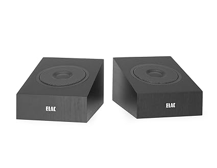

If installation on ceiling is not possible, you may choose up-firing speakers (or) Atmos module speakers.. These are usually placed on top of your existing speakers.. But this is only if you like them..
do you have any recommendations? Nothing expensive but something that can enhance the experience. How big a difference does atmos make when compared to traditional 5.1?
Example of Atmos Add-on speakers (below image), which you can place on top of any speakers..
Example of Atmos integrated module (below image)..

There is a ELAC 5.1 system which has atmos speakers integrated to it, don't recollect the exact model now.. May be that would be right fit for your friend..Klipsch also has atmos integrated speaker..
Am sorry, i misquoted the brand.. It is Focal sib Evo 5.1.2 system - https://www.focal.com/en/home-audio/home-theater/sib-evo/512-packs/sib-evo-dolby-atmos-512
