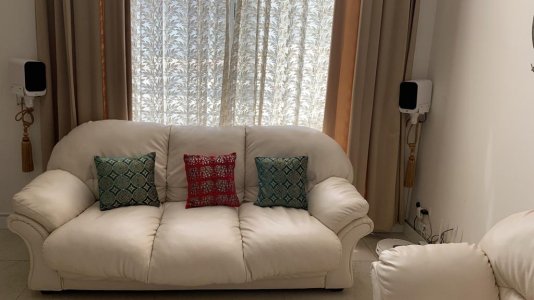

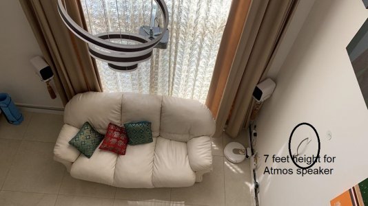

I am done with my 5.1 setup completed on Denon X1500H with Epson K1 Bookshelf for the front, Q Acoustic Concept for Center and Q Acoustic 3010i for surrounds with Morel PSW - 8ew (Pre-owned) for sub.
I was now going to add additional 2 surround speakers on side walls for Atmos/7.1 setup (My ceiling height is 20 feet around MLP so ceiling speakers are not possible). So I have decided to setup 2 height speakers on side wall at around 7 feet of height slightly forward of MLP and plan to angle it downwards to fire towards MLP but little ahead. I was planning to use it as 7.1 and Atoms depending on Movie. My rear surround speakers are on back wall just behind MLP. I have attached pics for better clarity of room.
I was not sure about height part of these additional speakers and choices and reaching out to experts here for their thoughts.. I watch a lot of downloaded 7.1 movies and OTT (Atmos) as well as music.
1. What should be height of these speakers. Its possible for me to put 6 feet to 8/8.5 feet. Higher the better or lower the better to get best for 7.1 as well as atmos.
should it be located little ahead of MLP or i should try to bring it in line of MLP as much as possible by moving little ahead.
2. What type of speakers should I choose. Any wall mounting surround speakers are good which can be angled or should go for specific atmos speakers. I thought of following options. Please suggest anything additional.
a) Someone offered me NHT Absolute Wall Speaker for 32K (Clearance sell, no bill and warranty)..I feel his ask is higher. He suggested to angle it using a mount.
b) Angled speaker like dali-alteco-c-1. Since i only need down-firing, so feature of up firing & down firing selection not useful, hence i feel its expensive. Advantage is that its already angled so need not worry for finding right mounts.
https://avstore.in/products/dali-alteco-c-1
c) wharfedale bipolar Diffuse Field Surround model specifically made for rear surround sound. Cost of 30K seems reasonable. Challenge is getting right mount for this.
https://hifimart.com/product/wharfedale-wh-dfs-surround-speaker-pair
d) General speaker like Polk audio OWM3. It is costing new only 18K and has perfect mounting for down firing. I am not sure if this is of great quality though.
https://www.amazon.in/Polk-Audio-Wall-Speaker-Black/dp/B0018QNYVM
How much should i spend in these speakers considering my current 5.1 speaker setup costed me 80K.
Please pour in your thoughts and help me complete my setup... 🙏🙏🙏

Hi PKV,
From the positioning given in the attached pix, I think they will work well as 7.1
I doubt though if these are the right placements for Atmos content. You might have to: 1) Place the height speakers in front of your MLP/couch, and 2) the placement will have to be slightly higher than 7 feet. I'd say 1 feet down from the ceiling, and right above the front L-R speakers.
See the pair above the projector in this pic from FM @ankitbhargava's set up:
Such a position might work for Atmos in your space.
If you are going ahead with the current plan, just pick up another pair of the 3010s and enjoy 7.1.
If you want to try the front heights, the OWM 3 are more than enough. Everyone who has them has only good things to say about them.
Trust this helps.

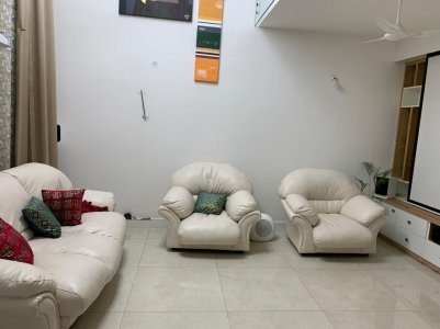

Thank you @k-pad. I can place the speakers upto 8/9 feet height as well. One thing which comes to mind is that if i place it that high, how will the 7.1 effect would be. My understanding ( And i might be wrong) is that for 7.1 movies speakers should be at same height as of rear surround but should be separated far from rear speakers. Is it like either I can optimize for 7.1 or Atoms (One of them only) ?
In the picture are you referring to red circles in ceiling which are slightly behind MLP and in my system it is 1 feet ahead of MLP. I have attached couple of pics to give idea of front L-R speakers and more clear view of proposed speaker.

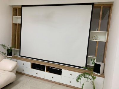

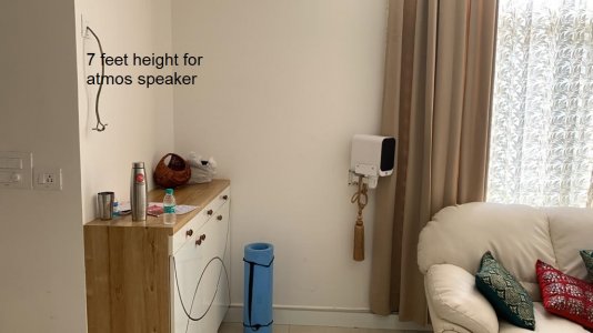

Attaching some additional pics to give complete idea of setup..

Hi Sir, the increased height will help if you are using them as front top atmos.
Yes, for 7.1, best to keep it lower and in line with the other ear-level/surround speakers.
In the other FM's pic, I did not mean the red circles, but the two angled speakers above the screen. Sorry, I confused you by saying projector I think...

Thank you.. I understood it now.. However placing speakers there will be little difficult now. I have only 1 option of placement (Wire you see in pics next to sofa on side walls) and need to decided on height for that. It would be angled to point at MLP..
Then, sir, I'd suggest keeping it as close to other ear-level speakers and using as 7.1, since you said you watch a lot of that content, but yes, you will miss out on all the new atmos content enjoyment...
