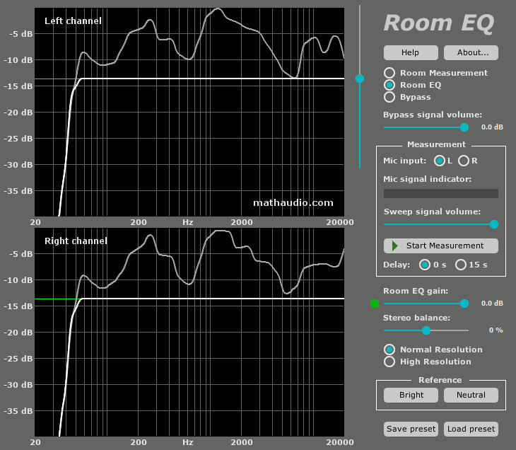

Ok I connected my Yamaha microphone and with no other disturbance in the living room, placed the microphone at my listening place ear level and started the help manual and did the room measurements and then saved the preset and loaded the same preset by setting the stereo balance on.
Now coming to what it did with the room measurements and the sound output, first of all it made my DIY bookshelf speakers sound big like floor standers (sound was full and clear without any distortion) and now I can hear a better quality/clear/vocals of sound at a less volume level. It has not colored the sound but made some improvements so all in all a very nice plugin for foobar without any coloration. My test songs included the AR Rahman songs in FLAC and the Gregorian chants in 320kbps.
I am not sure about what the measurements say but I think knowledgeable FM should be able to judge from the picture.
Here is the image of my MathAudioRoomEQ settings/measurements:
