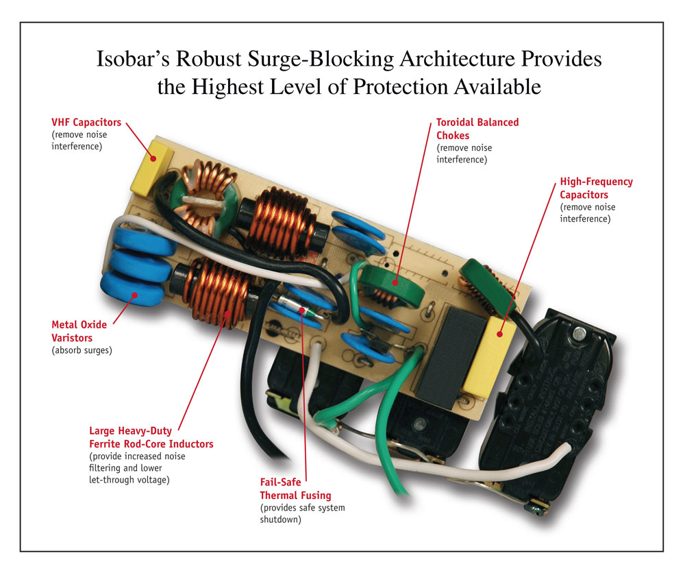

An extension strip is different from a spike/surge buster. Although both appear to have one AC cord and multiple switched AC outputs, the extension strip just has parallel AC sockets which is switched. For spike/surge protectors, there is a small circuit introduced between the AC input and the multiple switched AC outputs, something like this:
