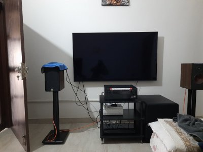

Ok so now its time to start in treating my square room. I have dali opticon 2 mk2 and cant hear dialogues clearly in 4k blurays hollywood. I know behind the speakers on front wall we need absorption panels. But what specification should i see to buy it? Also why some brands are cheap like mmt while viacoustics is very costly? Will cheap work for my room if i am just starting. If yes, how much thick it should be? what type of wool or material is good? what is nrc and how much do i require for opticon 2 mk2 fronts? And yes how much length and width do i require ? Also i have gates to sides of speakers do they also need panel?

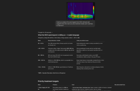

Since you already have UMIK-1, why don't you post them here. Also, drop it into ChatGPT for analysis and possible tweaks. It is surprisingly helpful. Much more in-depth and detailed for a beginner to grasp though.

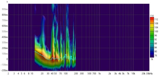

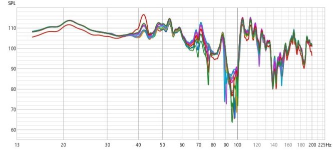

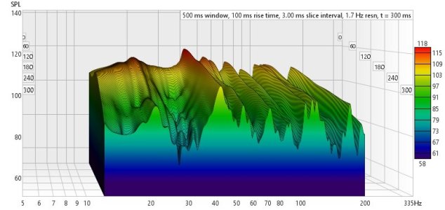

All this is captured from rew. after dirac live bass control 80hz . I did dirac live again today but that sound pressure has gone down . dont know why. like in godzilla monsterverse 4k collection that pressure is missing in many places.

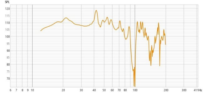

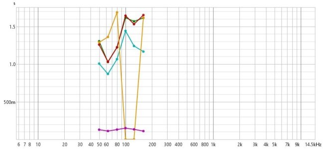

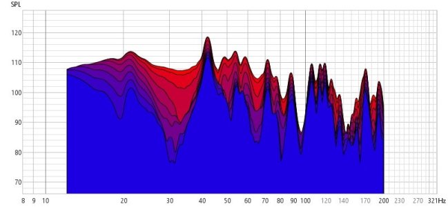

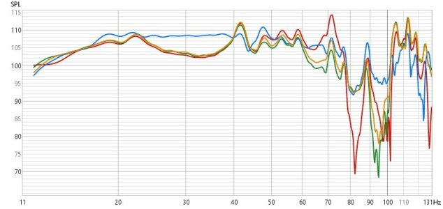

dirac live bass control is killing bass at 30hz area while with only dirac live filter its good. see blue line. why is this happening
