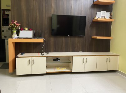

Mainly because of space constraints , My living room has a fixed tv cabinet which has very less depth of around 36cm and as far as I have researched almost all the AVRs (7.2ch and above) have a depth greater than 38-39 cm + will need room for HDMI/Speaker cables at the back
Plus cannot have a dedicated AV rack , so it’s a no go at the moment
Please suggest if anything else can be done to overcome this hurdle

Right now I am looking for a solution to tackle the space constraint in the cabinet.
If nothing works out probably will go for a integrated amplifier with R200s ,given IA would fit in my tv cabinet
You can ask a Carpenter to make a small stand and mount on the wall or the shelf.
For the number of "media consoles" and "TV units" available, hardly any of them have functional designs. In fact, I'd go so far as to say they are mostly utterly useless for anything more than an STB and a console.
Having said that, the most cost effective solution is to simply keep it on top of the unit instead of inside the shelf. My AVR (Marantz SR6013 requires a clearance of 45cm including cables.
At the most, the front fascia will stick out a bit (by approx 5 cm) but the feet will be firmly grounded. If you can make your peace with that, you may possibly be losing out on that last bit of aesthetic symmetry/perfection but you would be gaining a whole lot experience wise. Unless of course, the experience includes a righteous earful from the missus... or worse!
Nevertheless, it will also be the better solution insofar as heat management and longevity of your AVR is concerned as opposed to the shelves which are closed from all directions except the front (not that the shelves were an option in the first place).

Thanks , Sound bars are an option but I do not really like the concept of all the channels packed into one piece plus I do not really like wireless speakers especially the ones that need to be recharged
That’s the problem , I do not own this place so not intending to do any modifications
