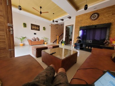

Hi guys,
I am new to hifi world...need help to decide on my first setup.
I have a fairly large room of 20*16 ft(pictures attached) and seating position would be atleast 10-12 ft from speakers/TV. Room is kind of an open hall cum living room.
I have an 65 inch sony Oled TV and would mostly be watching movies/ott series and casual music listening..60 to 40 ratio of movies to music.
I have shortlisted the below but now sure as this would be my first speakers ever and I am not an audiophile...I want my music to sound good, balanced(not over the top bass or treble) bit a tight punchy bass and smooth enough highs.
Please suggest speakers(preferably floor standing) and compatible AVR under a budget of 2-2.5 lakh including AVR.

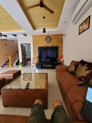

View attachment 72984View attachment 72985
Hi Deepak,
Welcome to the madness!
I see the room is already set up. :(
So, I have only two questions.
1. Can you place your TV on the wall where the three-seater is? And move the three-seater about 6-8 feet away from the new TV position? If yes, there is a possibility that you can achieve some bass with near-field placement. (a -VERY BIG- sub will have to be placed where your left leg is.)
2. If you can't do that, can you install a thick glass/wooden sliding/shuttered door from where the door to your left hand is and that other room in the front of the picture? You will have to cordon off this space to get good bass in this room as is.
If you don't want to make any changes to this room, I unfortunately will have to break the news to you (I guess @DB1989 is being too nice): Pressurising a room this size with so many openings to other spaces is next to impossible. Near-field is your only hope. And even then, that gorgeous coffee table will have to go. Or you need to drape it with a thick cloth whenever you are watching movies.
Regards and best
PS: As for speakers, give some thought to what you want to do with this room before diving into speaker purchases; thank me later.
Am assuming there is a smaller space somewhere in this house that can be dedicated for AV. :D
PPS: It's a gorgeous, gorgeous living room!

Thanks @k-pad
I understand your concern but unfortunately, I can't do anything about room. It's a living room and I can't have a dedicated HT room as of now, May be I will have it few years down the line but till then I want to get something that works for this room.
I understand now that I would not get the impact that I am looking for in this room but can I just start with a 2 channel stereo setup for music listening ? Maybe just with a good amplifier and decent pair of left and right towers? I don't want to do anything to the TV wall so I prefer floor standers.
Even if it is near field I am fine with it as far as I am listening to some decent sound.
