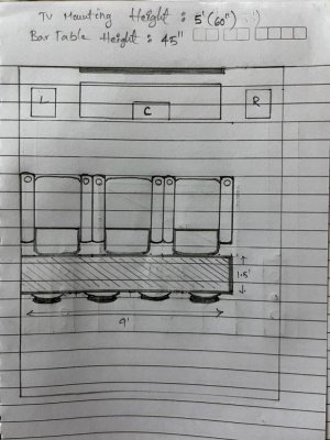

Hi All,
I am a beginner here and would like your valuable inputs in designing a compact entertainment room with mixed usage of music / sports / movies. Flexible with AVR budget. Open to treat the ceiling and first reflection points. Rear wall is a sliding window opening to a small terrace, hence planning full size heavy curtains.
Decisions made so far:
  1. 75 inch QLED TV wall mounted
  2. 7-7.5 ft viewing distance (2/3 recliners)
  3. Bar table behind the recliners with 4 stools
  4. 5.1.4 setup with surrounds on the sides
My Dilemma:
Floor standing vs Bookshelves vs on-walls for front left and right speakers ? Im quite apprehensive they might be overpowering in a room of this size. I am coming from a living room setup with Sony HT-RT 40 with no huge complaints, essentially a beginner here. I need to strike a balance between space / aesthetics / functionality here. Budget around 1-1.2 l is ok for the the main speakers (left & right).
Please share your valuable feedback here.

My room is 11*10.5 and I sit at a distance of 7-8feet.IMO bookshelf speakers are more than enough. Bookshelf speakers costing 1.2L should have better fidelity than towers that is costing 1.2L in most cases.

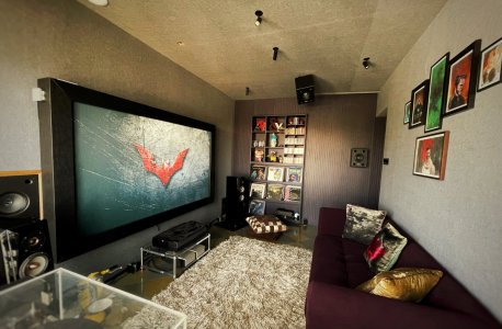

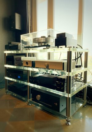

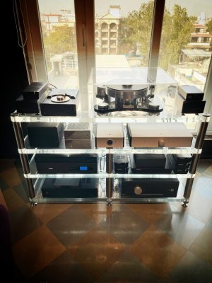

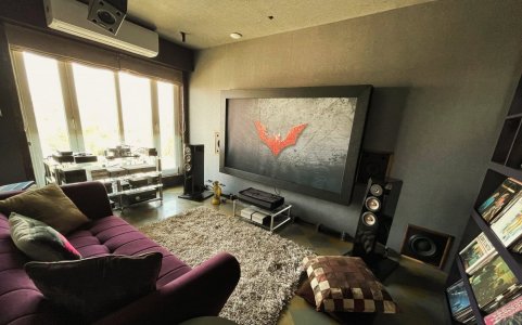

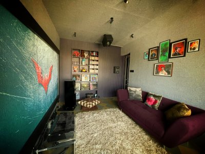

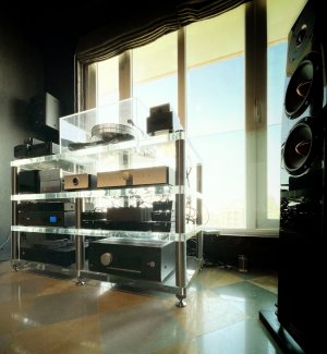

Hi Naveen , I have a similar sized room 13ft x 17ft which has become even more compact after room treatment. I use Floor standers for my stereo listion and have inwall speakers (FL FC FR + R sub + L sub) the remainings spealers i.e: rear L & Rear R and the atmos speakers are wall mounted. FLoor standers are definitely not overpowering. I too have a wall on the left which is a sliding window. Have attached some pics for our perusal.
cheers!
Anand
cheers!
Anand
Wow.. amazing setup!
Where is that AV rack from? I hv been looking for something like that.
Hi @Love4sound,
I have been considering the following loudspeaker for each category so far based on the forum discussions:
  1. FS: Monitor Audio Bronze 200 / Elac Debut 2.0 F6.2 / Dali Oberon 5
  2. BS: Elac DBR62 / Dali Oberon 3
  3. On Wall: XTZ Spirit 6 / Monitor Audio Radius 225 / Martin Logan Motion SLM
I do not see a lot of dealers online for XTZ. @Love4sound , could you let me know if there is any dealer to audition the Spirit series ?
Also, I have seen some members recommend Jamo D500 THX / Magnet Ultra LCR 100-THX for on-wall setups. How would such speakers compare to a traditional FS/BS setups ?
But I do not see any online presence for these speakers either? Any references for the right dealers here ?
Thanks,
Naveen
Right.. and for smaller listening distances like in this case, speakers with one hf and one of driver will be a better option. ( A speaker acts like a point source at 5x the distance from the speaker - x being the distance between the top most to the bottom most speaker driver)
Example - if a floor stand speaker has 3 LF drivers of 8" and one tweeter - total separation distance would be around 30 inches/ 2.5 feet.
Now this speaker will act like a point source at a distance of 2.5 x 5 = 12.5 feet.
One suggestion i have is that consider have two different orientations for seating. breadth wise for tv watching. length wise for stereo listening. The main advantage is that stereo listening sweet spot is usually one seat. Also helps to keep clutter minimum when doing either/or activity.

Superb Audio RACK 👌👌👌🎶🎶🎶
