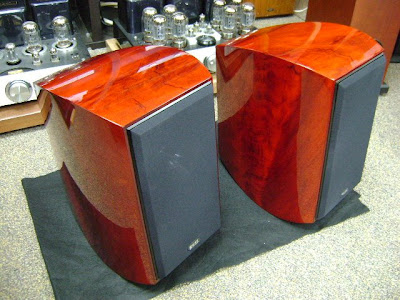

I'll be receiving my pair of Jamo Concert 8 bookshelves around July and something which has been on my mind is the finish of the wooden veneer.
The manual says it's real cheery wood veneer however it's not polished to a gloss, more matt. Since it's a thin layer of veneer I'm wondering if it's safe and possible to polish it to a gloss to reveal the details of the wood and bring out better contrast.
This is the speaker
And this is the kind of gloss I'm looking for
What do you guys suggest for achieving this goal?

Wax is totally out of the question, and I have no intention of changing the color of the cherry veneer.
I've seen automotive clear acrylic coats being used to gloss over wooden furniture.
It does a decent job and fades over time without harming or staining the wood.
However it's nowhere near the mirror like gloss and beauty of french polish and french polish is too tedious.
Is polyurethane considered a varnish?
We once tried using varnish on a piece of ancestral furniture and it bonded with the wood. The only way we could remove it was using a chisel to scrape it off. Greatly angered my mother and we haven't used varnish at home since lol.
What kind of polish do you think the speakers in ths picture are? I have a feeling it's polyurethane. My d830's are a similar veneer, wish I could get a finish like that >.<
