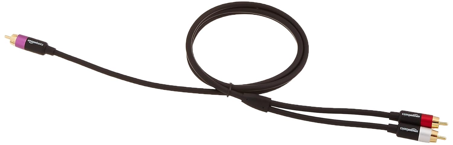

Can just post a picture? Check the cables, any free ends of Y touching Amp chassis?
Each sub-out of the AVR is connected to both RCA ends on the sub-woofer. Nope it isn't touching the amp chasis..
I somehow have a feeling the Y cable is the culprit
Proper shielded subwoofer cables will not cause this at all.......when i auditioned the TSW 10 at M Z Audio, a normal shielded subwoofer cable (single) was used.
Amazon basic cable.. Both sub's use the same cable..I really don't understand why only one sub is making all this issue, while the other sits quietly..
