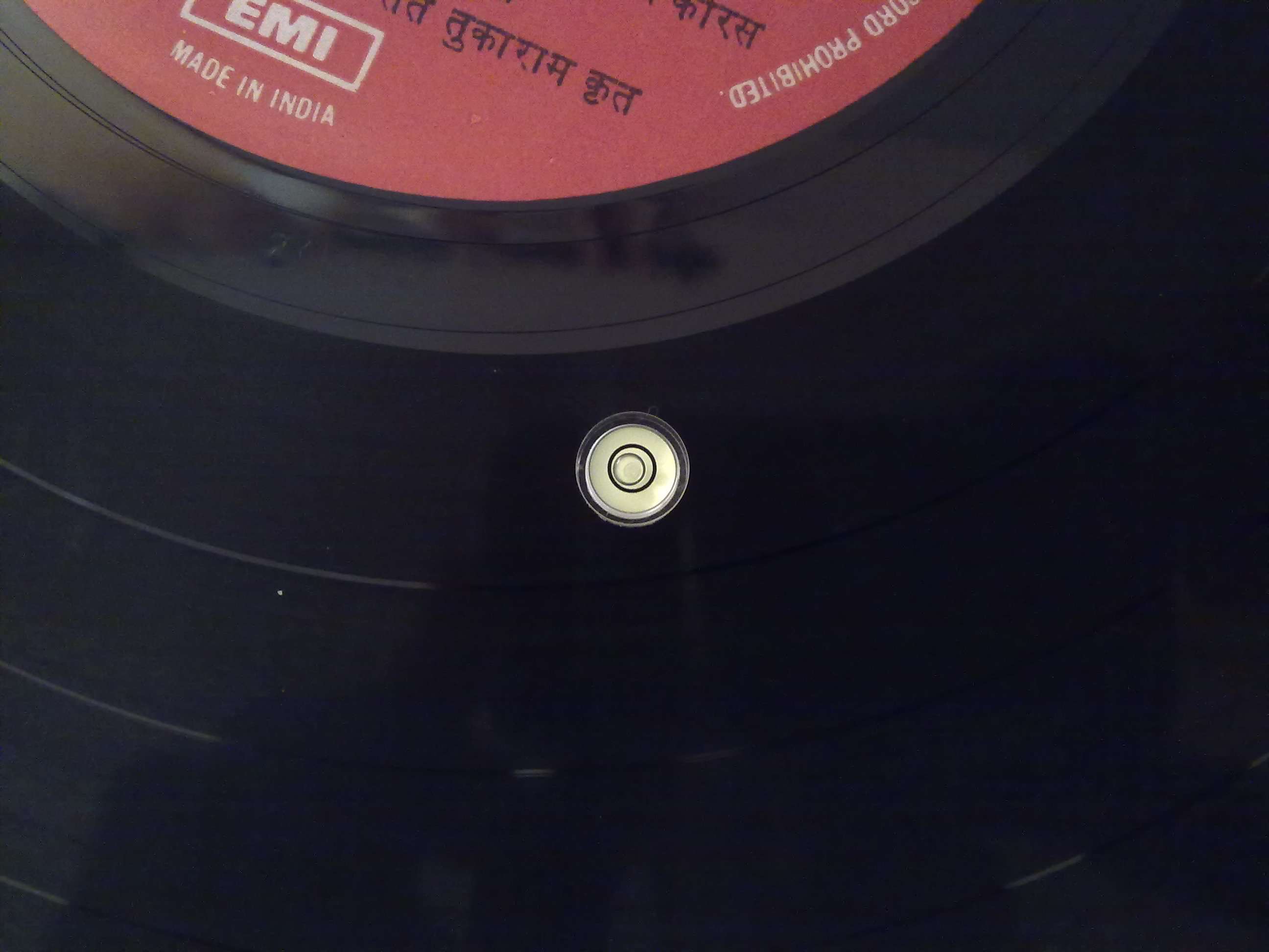

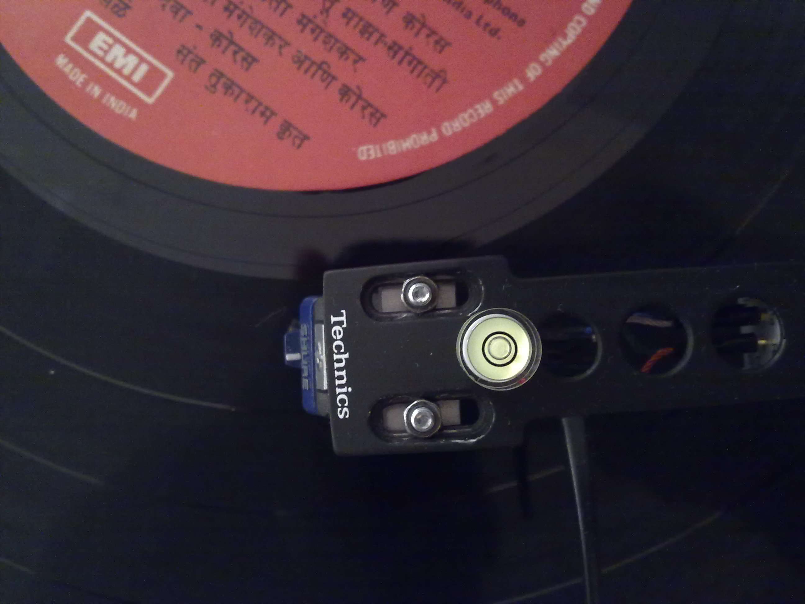

Just thought of telling my method of checking above settings into my SL 1200MKII.
Before and after aligning two null points and proper overhang. I do following test to check setting correct. Please forgive for bad picture quality and parallax in taking photos. They may not appear exact centered but they are actually.
At this condition the sound quality is the best from any kind of undamaged record. IGD is not existent though I can feel loss of HF.
NOTE: spirit level weighs 0.2 grams and tonearm in second picture is resting over record while it is stand still.
Wow, the spirit level test , i believe is the most accurate method of checking the tonearm level
