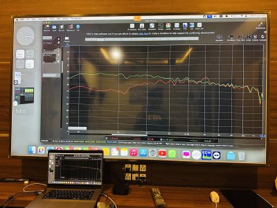

Although I achieved a good bass response at the main listening position with the help of UMIK and REW, it's not consistent in other spots. In our living room, we have multiple seating positions, and our family seats at different spots when watching movies. So, if I'm getting that good bass feel at main listening position, others might be missing it in nulled zones. I tried crawling to all positions in my room, but nowhere is the bass performing as well as the main listening position, which is quite sad because that was the whole purpose of having a total of four subs – to improve bass evenness and reduce seat-to-seat variation. I'm still missing that smoother bass across a wider listening area despite sacrificing aesthetics and going for all four subs. I'm not regretting buying multi-subs, but I am somewhat disappointed with the outcome. Am I over-expecting, or do I just need to find the right solution HERE?

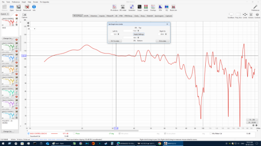

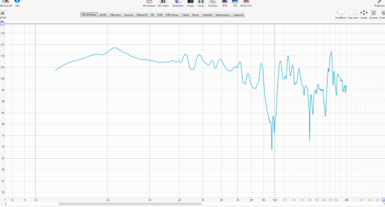

hi Can you send rew graph again by selecting range on right side and fit to data. have you applied any smoothing to graph? graph seems great. This is my graph after dirac with 80hz crossover. For multi subs dirac is very much helpful. But your avr does not support you need to do it manually. Its a very long process. It was very for 1 pb 2000 pro cant tell how much time will it take for 4 subs. I could have given you great price for dirac with bass control but it does not support it.

First remove port plugs from all subs and select standard in svs app. Then you will suddenly see massive difference in SPL
Thanks for the reply, will send you once I am back home. Just out of curiosity, I'm wondering if upgrading to an AVR with Dirac Live would be genuinely worth the investment. Would it significantly improve the output or subwoofer performance, especially with the inconsistent bass issues I'm facing? I really need to weigh the pros and cons before considering such an upgrade, and how does your sub sounds?
