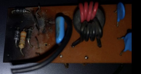

I just checked up the audioquest power quest 2. Iam sure it can filter out the EMI/RF noise ( I was using a similar isotek evo3 polaris many years back, which smoothened the treble and made the back ground blacker. I opened it up one day, and was aghast to find a 4x4 cm board with some caps in place. I was dead sure, that there wasnt enough there to stop a huge power spike ) So colour me a skeptic, but i have my doubts about the power protection part of the audioquest. So I would recommend to add it, at the end of a power protection device, like a CVT etc. If you do go down the online UPS route or a combination of CVT + isolation transformer, then you won't need the extra filtration, unless you live in a high RF environment, and using unshielded power cables. All the best:)

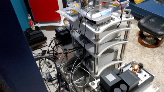

Iam just posting a pic of the PS audio, it is right at the bottom of the rack, with heat sinks jutting out at the sides. Has 3 massive Transformers, and is almost 2,5 feet long. Weighs a mammoth 78 kgs naked. Is a 4 man lift. Has killed itselves twice, for the sake of diligently protecting my gear for 5 years now. I will never part with it, unless one of us is dead :D
So I guess size matters, and small power extension blocks with in built power protection or surge protection, might not always deliver the goods.

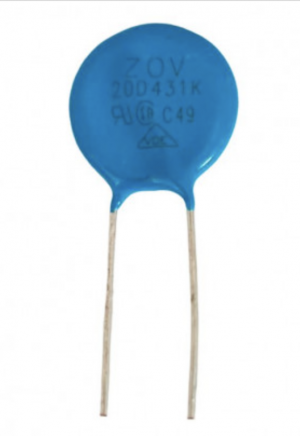

What you saw when you opened audioquest power quest 2 would most probably a MOV (metal oxide varistor) and not a capacitor. It is the same thing that is inside your belkin which blew up. These MOV short themselves when voltage crosses the threshold that the MOV is designed for. The short will cause your house fuse to blow off or trip the MCB. In that process the MOV will mostly like totally get burned. These MOVs cost less than Rs 40 usually.

+1. Power strips with surge protection are based on MOVs. They short the output when voltage transient crosses a threshold it clamps the voltage and starts throwing off extra voltage/energy in form of heat. This should cause your house fuse / circuit breaker to go off.
MOVs cannot be a substitute for something like a CVT, voltage stabilzier. You can put a power strip before a CVT and after a CVT. But power strip shouldn't be the sole protection mechanism.
Here is a good funda on how they work. littlefuse is a well known company that manufactures them. Belkin, audioquest, etc just just use them inside their devices and maybe add a hefty markup for brand value.
