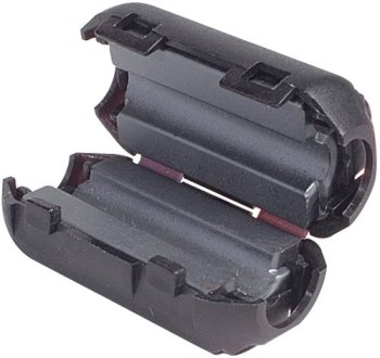

One of them is connecting my DAC to my netbook without any issues. Good quality ones have some filters built in, usually seen as cylindrical dilatations at either ends which usually are inductors wound over a carbon core, which prevent "dirty" pc voltages to pass to your DAC circuitry.
Google that last one... I'm sure I've come across some reference about those filters actually doing more harm than good! No idea what/why. Too late for me to find my reference as I only have a vague clue where to start looking. If I can add it tomorrow I will. Or else I dreamed it!
The ferrite core filters seem to be available separately also. So you can snap it on and try to find the difference if you are keen
