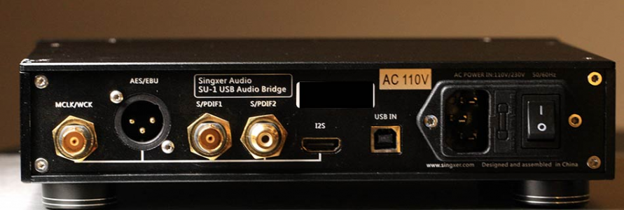

There is this singxer SU1 which gives USB to AES/EBU, I2S, etc
SU-1 digital interface of our team to develop a high-performance USB digital audio interface, using the XMOS latest xCORE-200 series chip. SU-1 is the independent development low jitter clock digital system interface(CRYSTEK CCHD-575/957 SERIES). SU-1 digital interface using standard USB2.0 input interface, while SU-1 has many output interfaces,including XLR Balanced Output AES,coaxial RCA and BNC,using HDMI socket output I2S port,WCLK clock output.
AES is mostly directly compatible with coax SPDIF. Both are 75ohm interfaces, SPDIF typically an RCA connector and AES-3, a BNC connector. AES-3 is 1 volt while SPDIF is a max of 600mv. As this is "digital" signal the voltage mismatch is insignificant.
AES-1985 is the balanced version over 110 ohm twisted cable using XLR connector. Now Canare makes matching AES transformers that convert from XLR to BNC and with a simple BNC to RCA adaptor, this should work.
The one difference between AES and SPDIF was the channel status bits. In AES these are used as metadata. In SPDIF they were reserved for copy protection on consumer DAT machines in the early 1990s. Now as consumer DAT was a flop, this never was deeply implemented and most consumer will just ignore this bit field in the AES packet.
